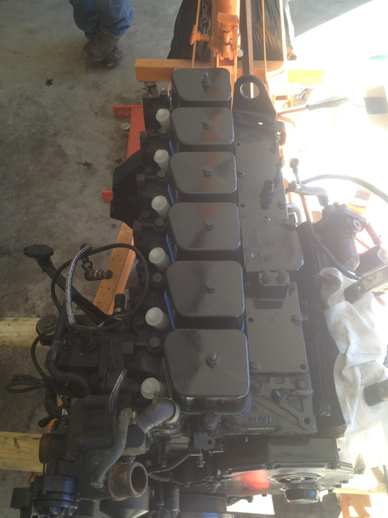

LOL My dad talked me out of putting the lines on, Kylie has already complained that they're gonna get all chipped up, but the injectors are in and torqued down. Finally painted the valve covers last night, gotta track down the fan hub bearing today. Still looking for an industrial exhaust manifold if anyone has one...

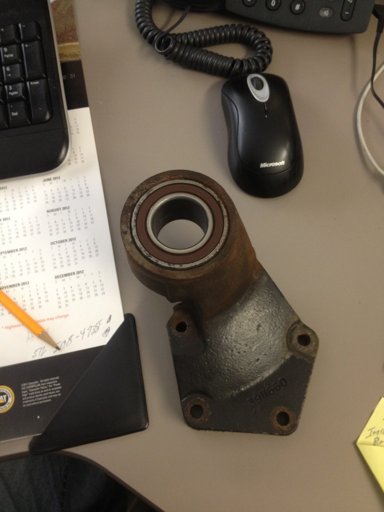

Does anyone know of a place to get the fan hub bearing? Dodge wants like $320 bucks just for the bearing! We've called around to a few places and looked online and no one else seems to carry that bearing.

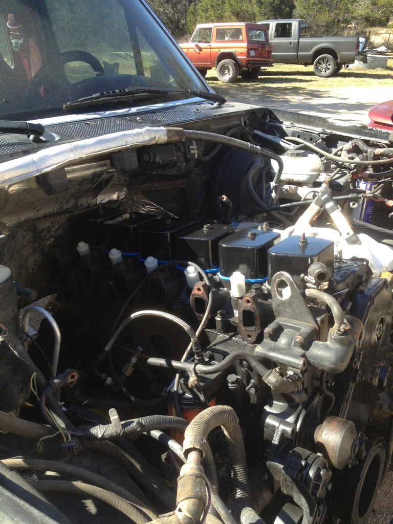

Colton (Idiesel) came over and helped me and my dad drop the engine in today. He also set the timing at 15.5 degrees, we've also been talking about taking the his old 181 delivery valves and running them. We're hoping to get the trans and tcase in this weekend.
6.0 p-stroke
Moderator
2,154
North of San Antonio, Tx
I left yesterday to do a little fishing and when I got back last night after my date I saw that my dad decided to put the tranny and tcase in. He told me this morning that we might need to pull the engine back out to massage the firewall a little for clearance on the last valve cover. He also said the front drive shaft was hitting the crossmember, I haven't looked at it yet but he said we might be able to raise the transmission a little to get the clearance we need.

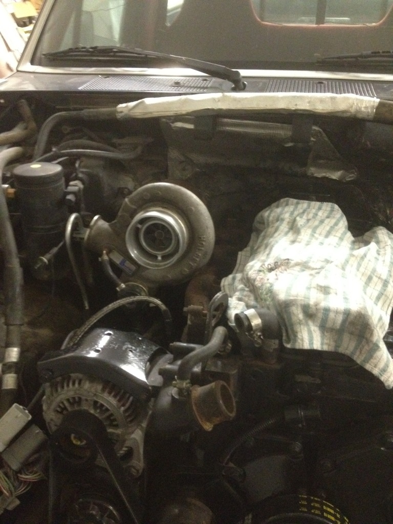

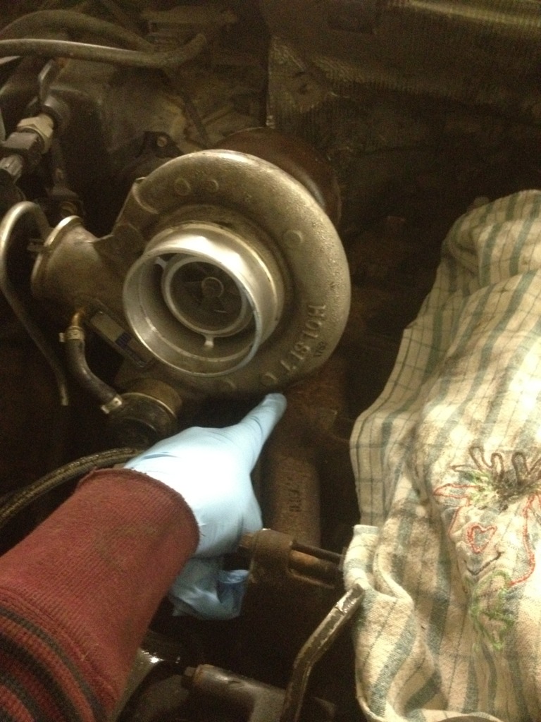

Well the other night I tried flipping the manifold over, it's close, but no dice. The compressor housing hits the exhaust manifold, I can't clock the housing either due to the waste gate actuator being mounted on the comp housing. I've been looking online for an industrial manifold and will probably order one today. I'm also going to call around and get some more info on what it's goin to take to get the tach to work, I'm hoping to be able to just wire it in but I remember reading before that It'll need a tach ring.

I was reading a fuvkings swap on cummins forum (I don't like fummins so I call them fu*kings) but he got a spacer for the manifold/turbo and it cleared
Idiesel
Oct 30, 2012
283
Texas
Did you ever try swapping the exhaust housing from the original charger or no?
