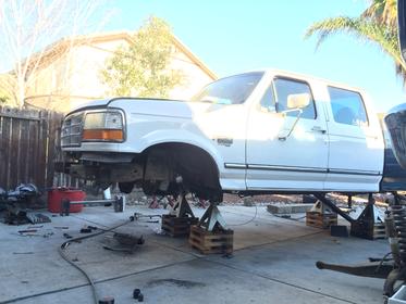

Did a sas and 5 speed conversion on my 2wd auto crew cab OBS. Here's some pics of what I did, to help others with similar swap.
Parts used:
6" front springs
Sky 3" rsk
Sky shackle hangers
4" drop pitman arm
Ruffstuff track bar (not on yet)
Dana 60 of course
8" super duty rear leafs
1" blocks in rear
For 5 speed:
Zf5
South bend single
Single mass flywheel
Starting off with some tear down pics and detailed pics to come
