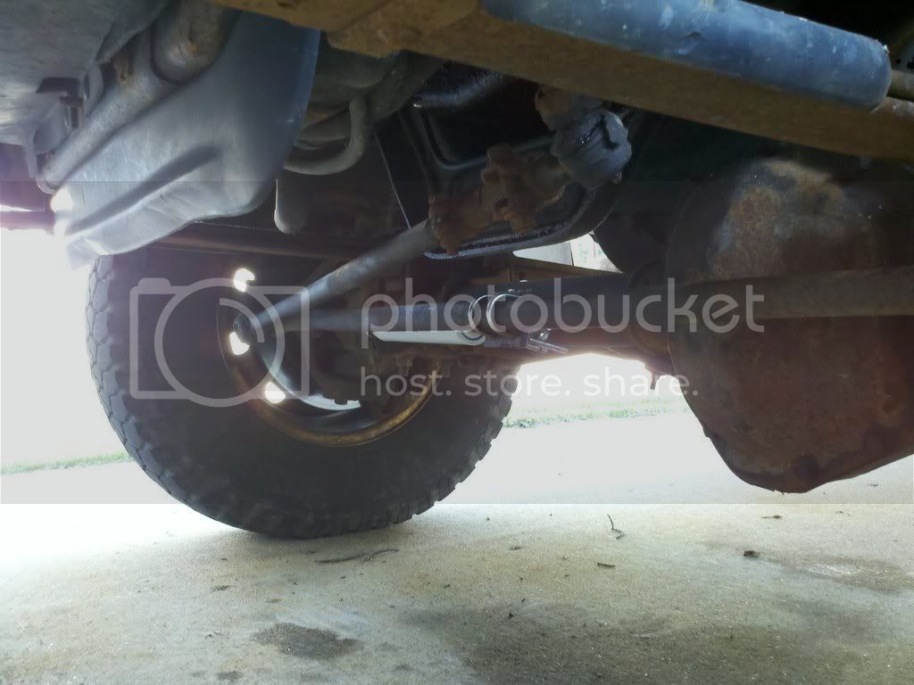

I can't help with a pic but I can tell you how I mounted mine orielys has a mount kit for around 30 bucks I used it to mount it to the tierod and on my 60 on the passenger side u bolt bracket on the axle there was allready a bolt hole to mount the other side hope that helps

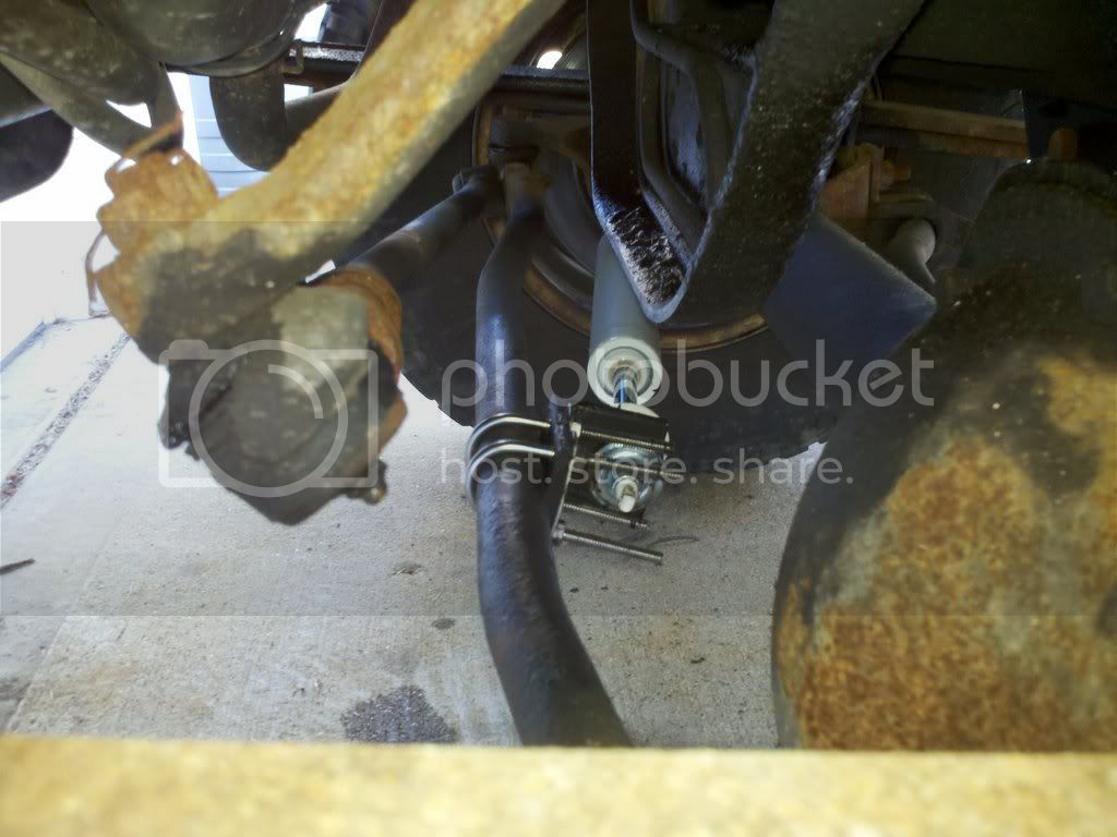

heres the pics

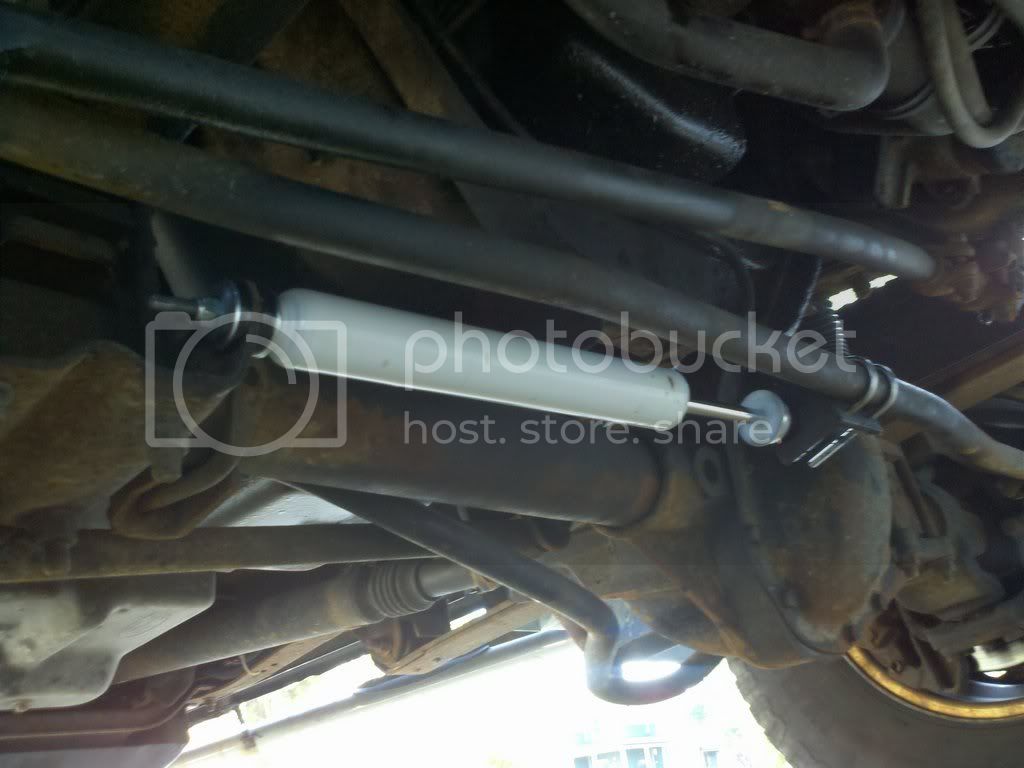

Here are a couple of shots of the mounting hole top and bottom

I finally got a dampner put on. It is a Gabriel from autozone. Took a little doing to get it centered so I have full range of steering, but nothing too bad.
I do like this. It took out a lot of the jerking of the wheel going over bumps and potholes. Now my wrists don't hurt after a few railroad crossings. You still feel a little of the movement, but it is much gentler and not near as harsh.
Definitely a good addition to a D60.

I had to make my own mount. It wasn't hard. 1/4' plate and a little time made a nice mount.
I used #136 stainless u-bolts from my local True Value hardware store. They were in the plumbing section IIRC. Their stock number 9222430.
Rubberizer undercoating is what I painted the bracket with.
