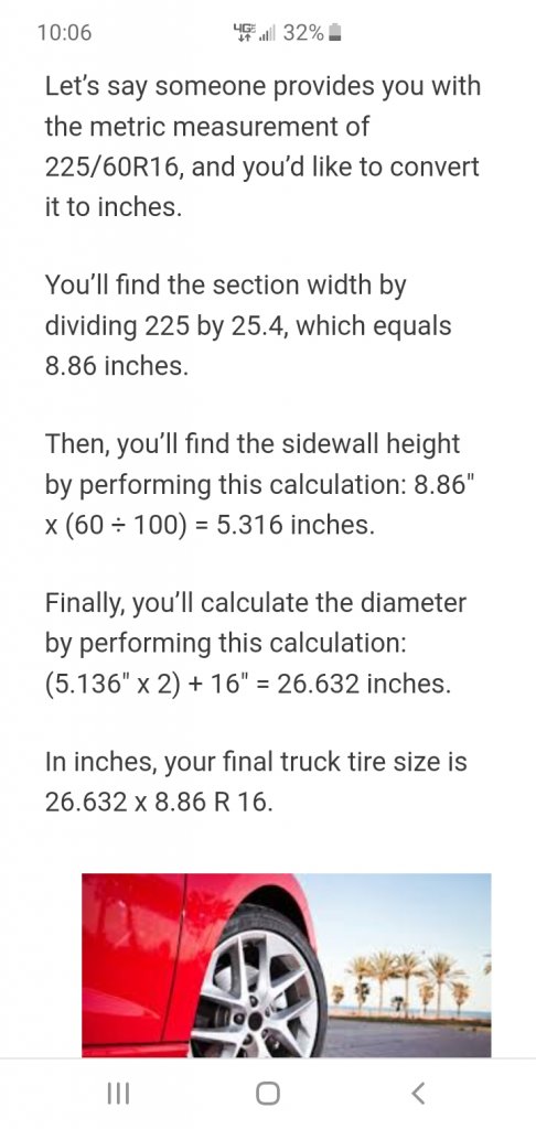

Its not just standard vs metric. There is an equation that you have to do to convert it from metric to standard.
First number is width, second is aspect ratio then obviously rim size. Rim size is always standard but you have to convert it to metric in order for the equation to come out right in order to get the hight of the tire.

Like this
