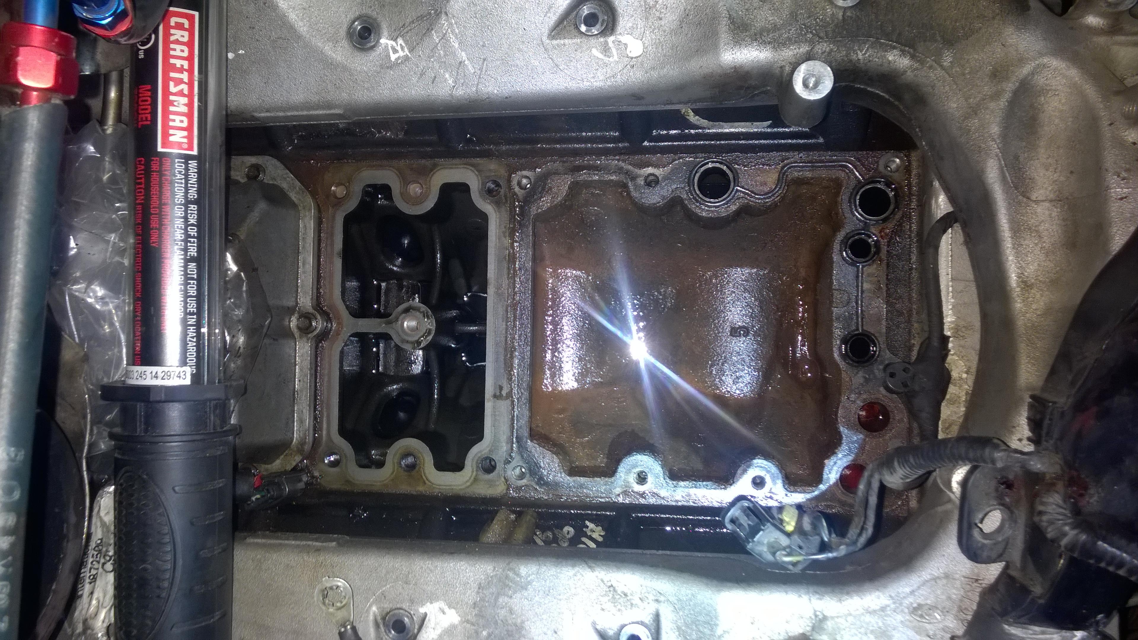

Now here is what it comes down to.. I believe this oring seal for the two coolant passages is the culprit. But I'm not %100 sure. What do you guys think. Again, I had coolant in the valey, it ran down both sides of the rear of block and a little up front. It never puddles up or anything really bad. But the always alot of coolant on bottom of engine and drivetrain.

Was filled with coolant

Here is the coolant passage o ring seal. What do you guys think? Just get this seal and hope for the best?
