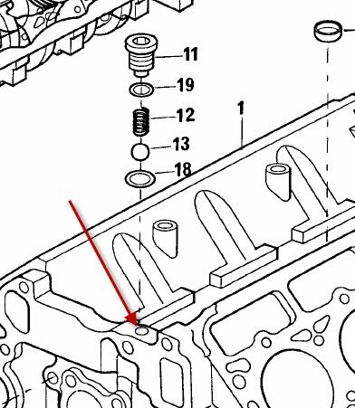

The check valve in the block may have something stuck in it. Iirc it's a 3/8" square drive pipe plug.

Thanks for the link. Getting on it today. Work got in the way this week. When I got it started after replacing the ipr and icp it ran better than before. Must of had a couple of problems. Do I take the reservoir off to get to the valve or can you get to it inside the reservoir?

Seen where it was and it doesn't look easy. Took the hpop lines off at the heads and both rails had oil in them. Neither oil line had oil in them. Would that be agood sign that there is no problems with injectors or o rings? Filled the reservoir and left the lines up. Just pasted the one line at a time for now.
