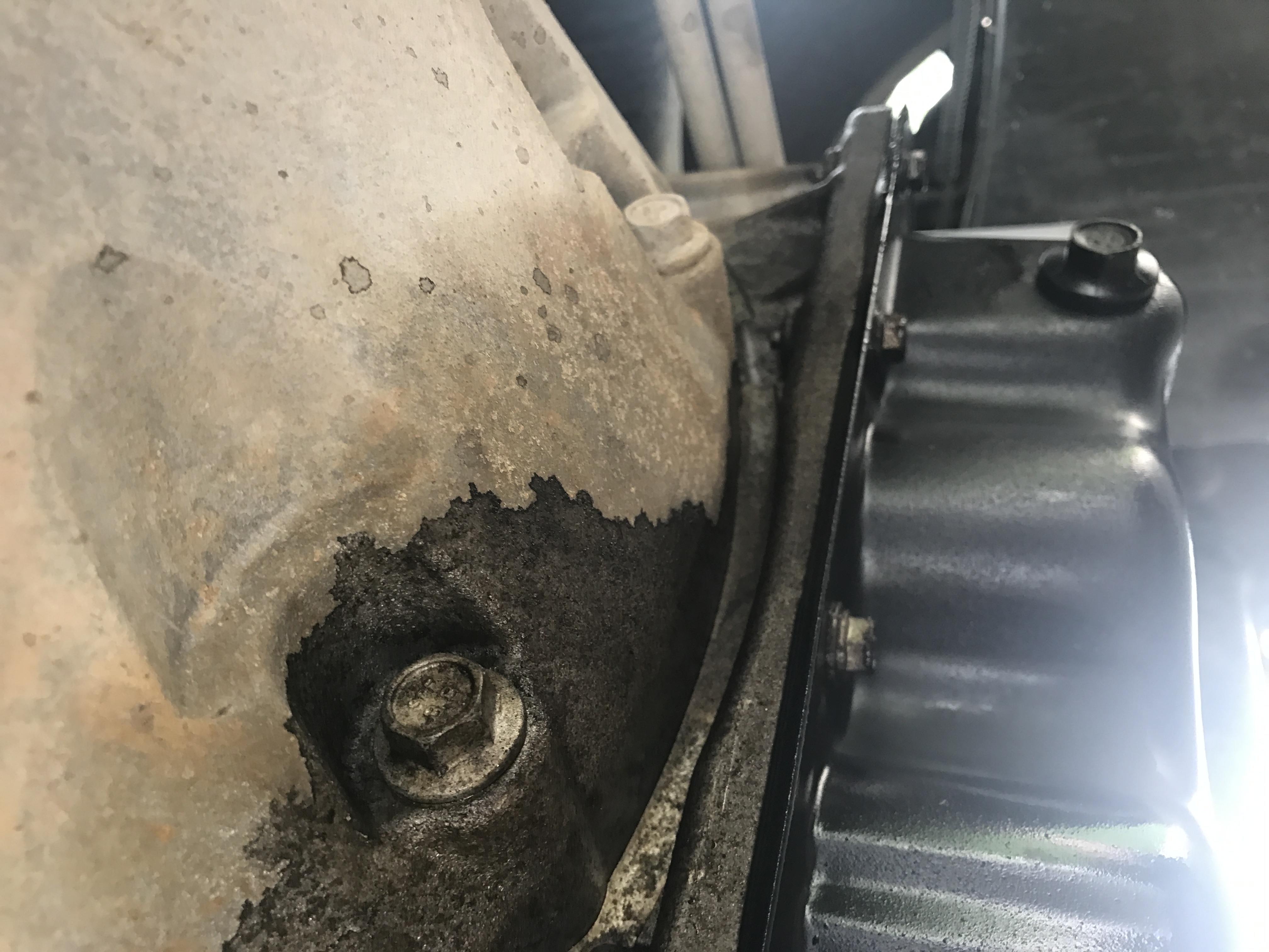

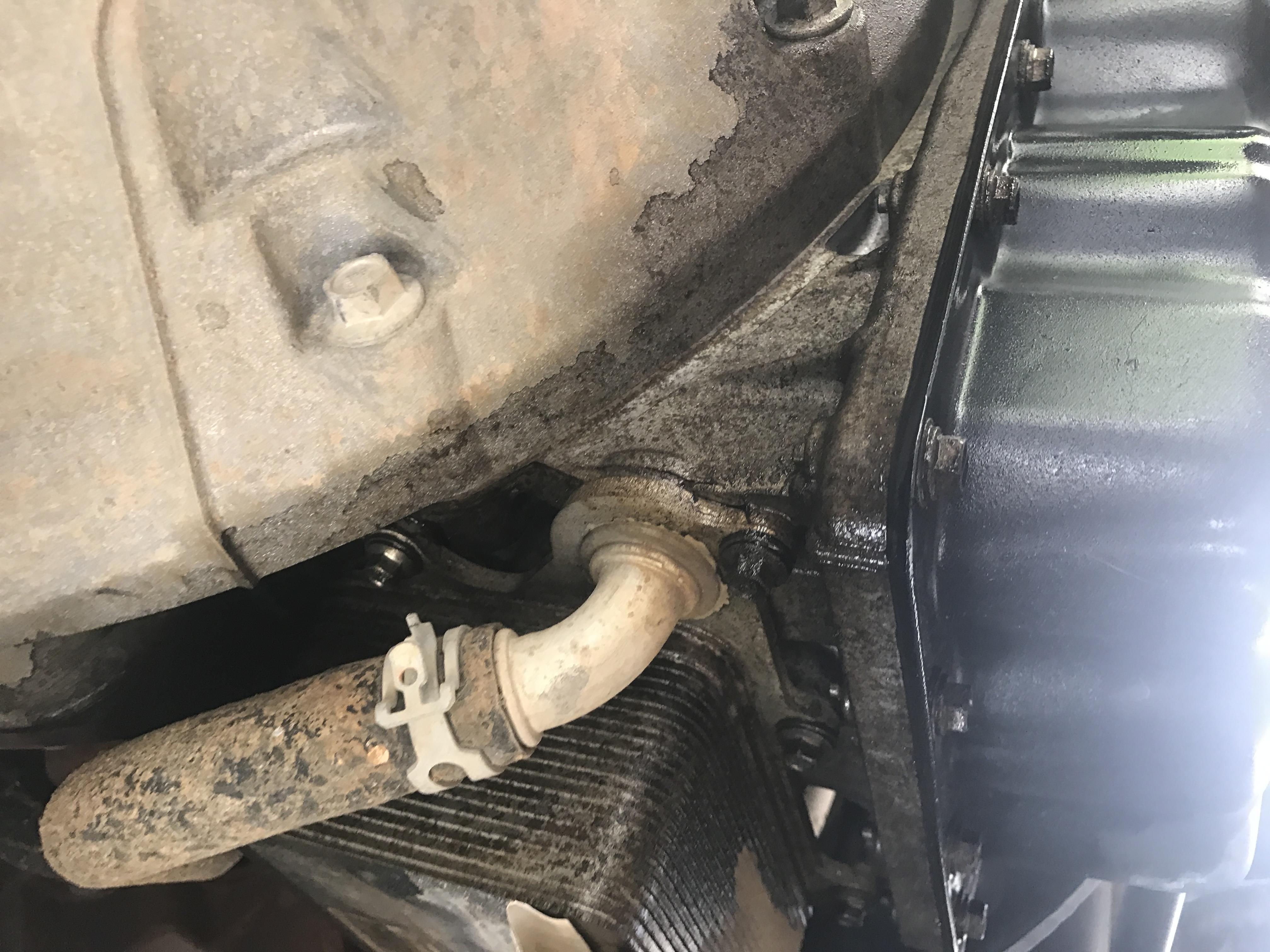

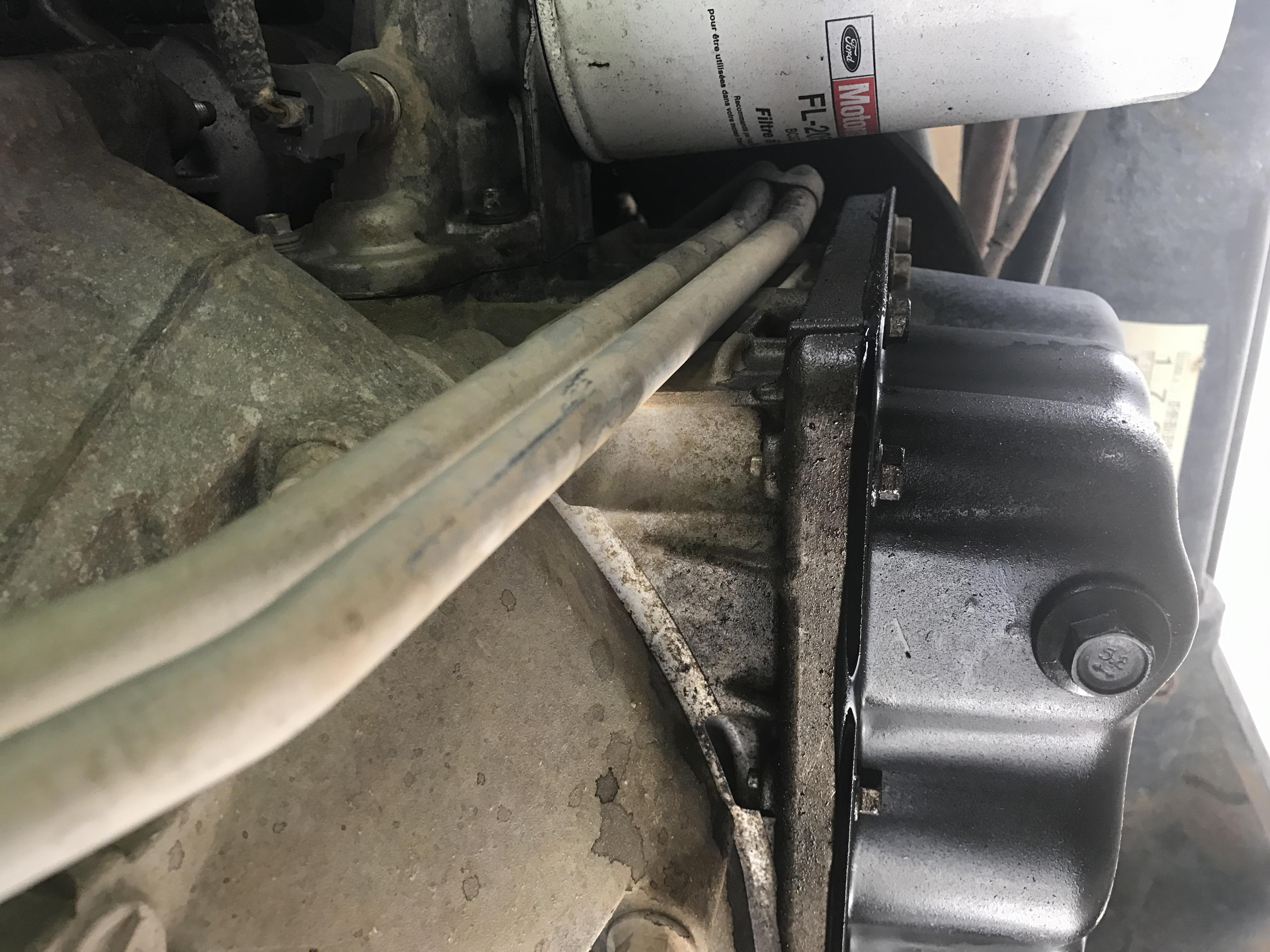

Truck is a 15. Has 65k on it. D e l e t e d and tuned. It started after I changed the oil.

Some will run off the filter and pollute things. I suggest clean up and monitor.

Check towards the front of the motor, been seeing quite a few upper oil pans leak lately. Much like a bedplate on a 6.0, it will run down and pool at the back like that.

The oil leak is back. I can see it coming between the bell housing and the transmission then making its way to the lower oil pan. It doesn't seem like rear mains on 6.7s are a common spot to leak.
The ford tech said he used a dye to determine where the leak was originally. Any other suggestions?

check the valley of the motor and see if its wet. could be turbo pedestal gasket. Also check where the filter base bolts to the block. with leaks you have to keep moving up until its dry...

Honestly, it seems that every upper oil pan i do, when i look at the rear main, it is somewhat wet as well. It may not be bad enough to leak out the bell housing at that point and time, but i put one in anyway so the trans doesnt have to come back out.
But ****, i guess that dont help you much after i read back some... I would check the valley, like sootie said, and hell, he couldve rolled the seal or something putting it in too. The 15+ trucks dont typically have major leaks in the valley like the 11-14s, but i have seen a few.
