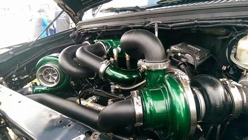

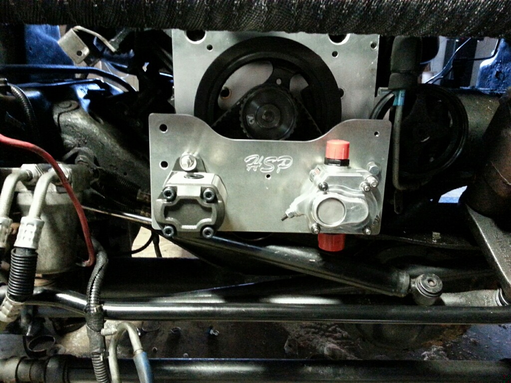

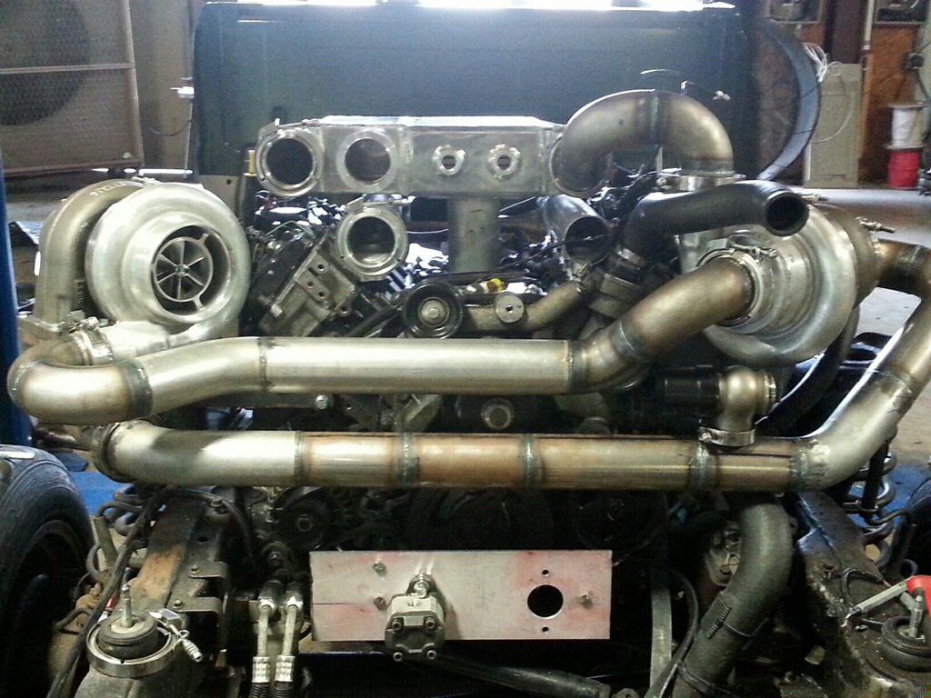

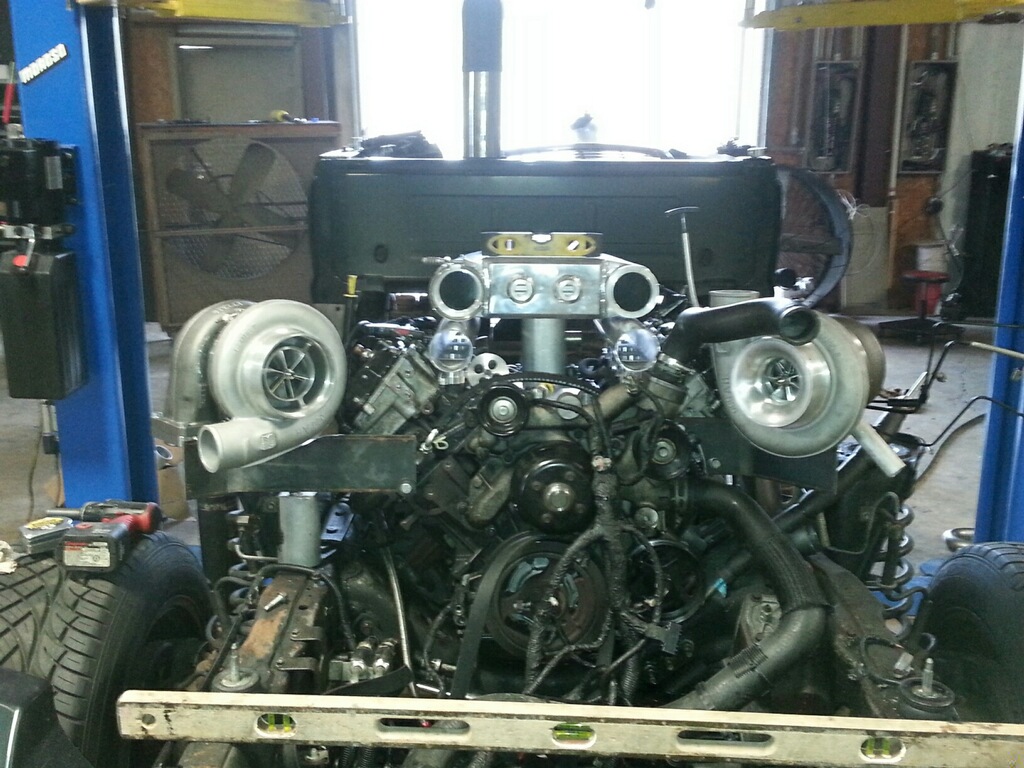

Well it's about time I started build thread on my 6.0 ill start off by say there is a lot of different and new things were trying. So far it has a compound setup dual HPOP air to water intercooler external low pressure pump and the list goes on this is just the start also need a name for the truck so throw out some ideas

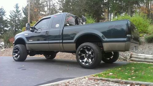

Ah...I was gonna say...lol! So you're changing the compound setup again? It looked pretty sweet before all painted up! How do like those Fuel wheels...I've been wanting to get those exact same ones for my truck!

No not changing compounds thats just what it started out as lol. Got to say I love the wheels man there different really haven't seen anyone with them so thats was a big plus that not ever tom dick and harry had the wheel

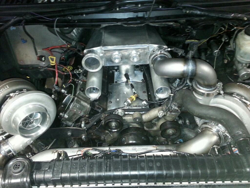

This is pretty much the finish project still doin alittle bit of custom work

Ok turbo's are 468 feeding a 483.5 built by barder. Injectors are from warren diesel they are 430/150 it idel rough because there was still air in the oil system. Air to water intercooler from frozen boost, individual intakes runners, custom external lpop, two stage nitrous kit work on putting the radiator in the bed as of now
