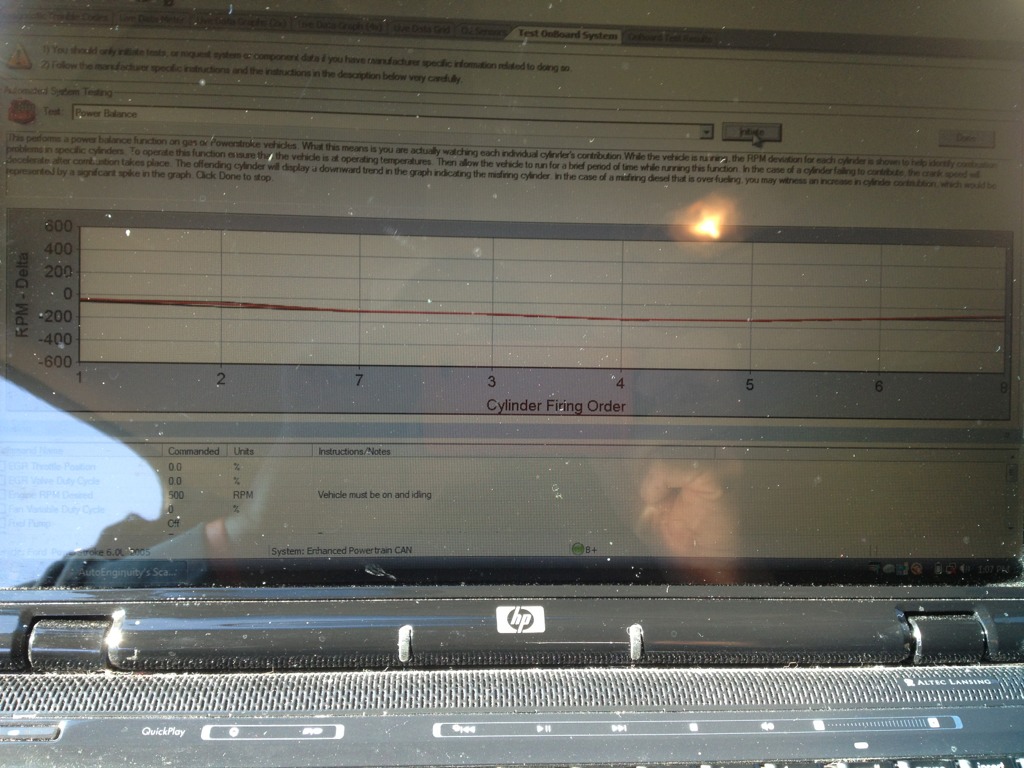

So I have injectors sticking like hell. Tried Revex but it didn't work. Was getting a code for #5, but now I'm also getting one for #1 that comes back every time I clear it off. Did a buzz test this morning. #1 and #5 don't click. This power balance was ran with temps around 160. 1 and 8 stay close to zero, but 2-7 all drop below. Opinions?

Looking at the power balance, do y'all think all of them look weak? Like I said, I did the buzz test on a cold engine and the two I mentioned were the only ones that didn't buzz. The rest clicked/buzzed as the were supposed to. Most of my income comes in the summer months, so $400-500 for 2 injectors is easier to bite off right now than $1500-1600 for a full set.
