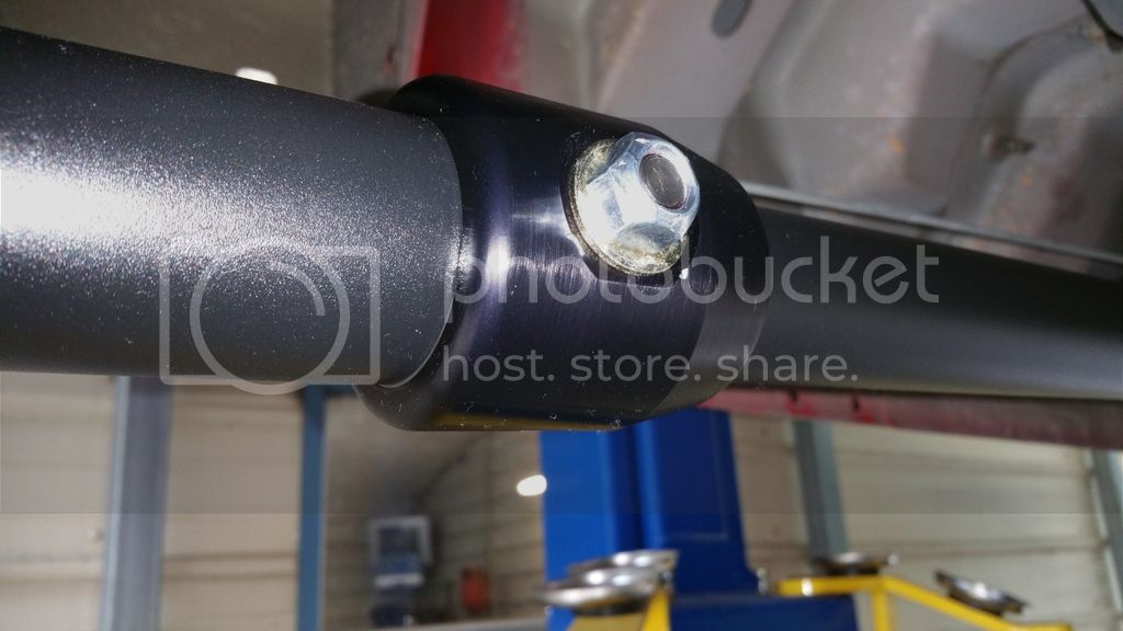

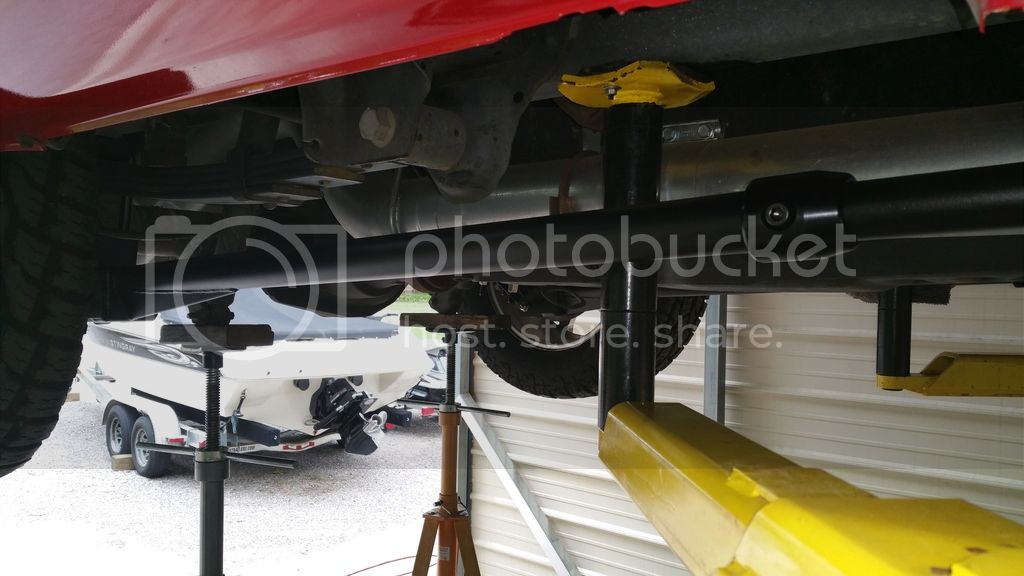

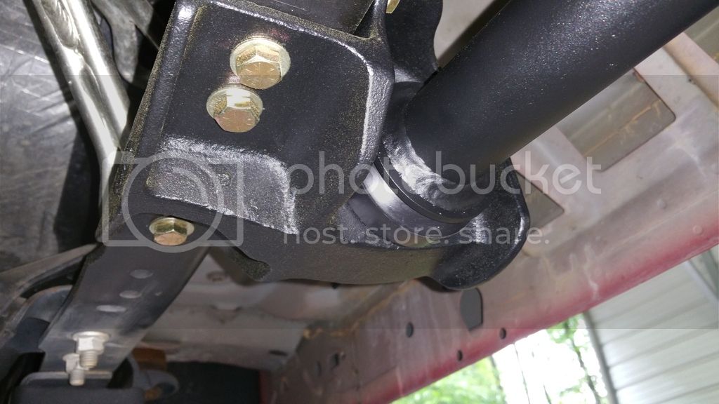

Well finally got suspension and bars done! Word to the wise. Don't pull more than Bottom Load leaf. Pulled 2 bottom leaves first and truck dropped 3". put the 4th back in so just the fatty is removed and sits perfect! Rides perfect and feels so much better.Very pleased with the outcome and it actually is trying to hook now.
