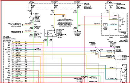

I believe it's the tan/ white. It goes to the switch but I do not know where it goes from there. I put a ground on it and that keeps it from turning overdrive off but I cannot hit the button because I will pop a fuse. I have it like this just to get by until I can trace original wire
mandkole
Jan 14, 2012
2,305
Northwest

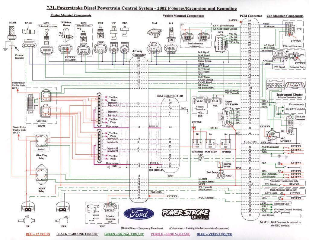

The TCS wire goes to the PCM.. pin 29
some pics
