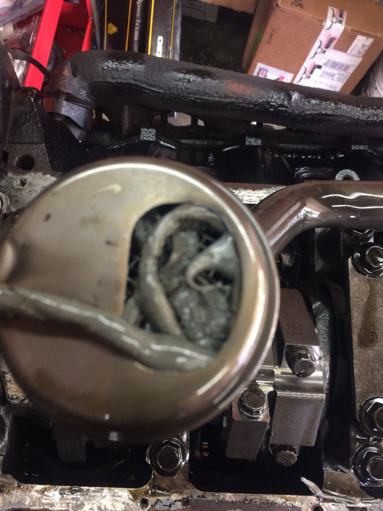

In the past year, I’ve come across two trucks where the oil pain had been replaced. The person who replaced the pan used a bit too much RTV. Excess bead dropped into oil, seam around from awhile and eventually got sucked into the pickup screen cage. It looked like a coiled up grey snake in there. Low pressure reading was ok on testing but pressure won’t equate to flow.

If the screen got obstructed like the one in the photo, it will act up depending on how obstructive it is. It’s all about flow capability. Definitely more so when volume and pressure goes up.
The plug adapter kit is definitely the way to go for testing Orings and pump function.
