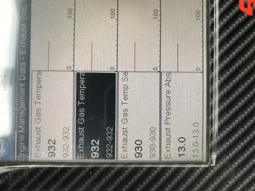

gotchadollar
Jan 1, 2016
299
This is KOEO

gotchadollar
Jan 1, 2016
299
This is KOER at idle
