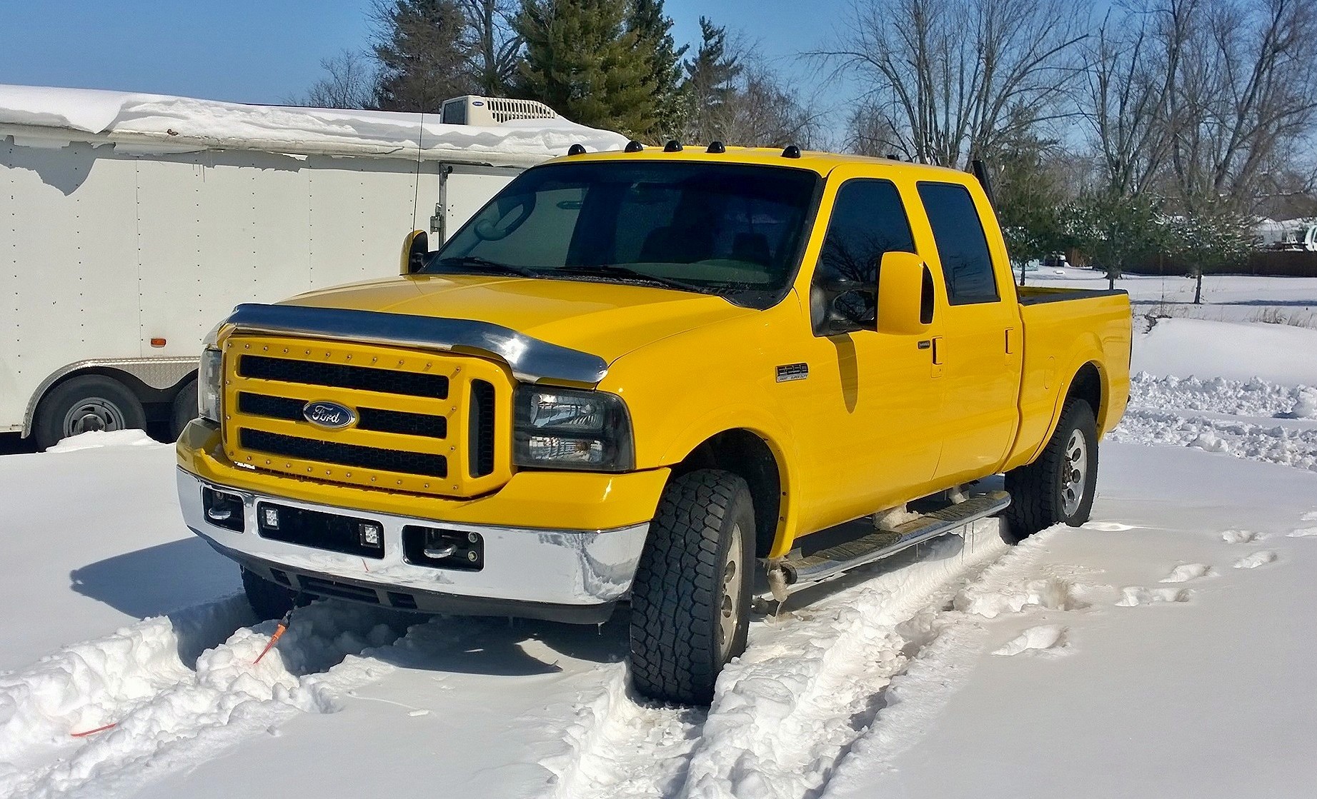

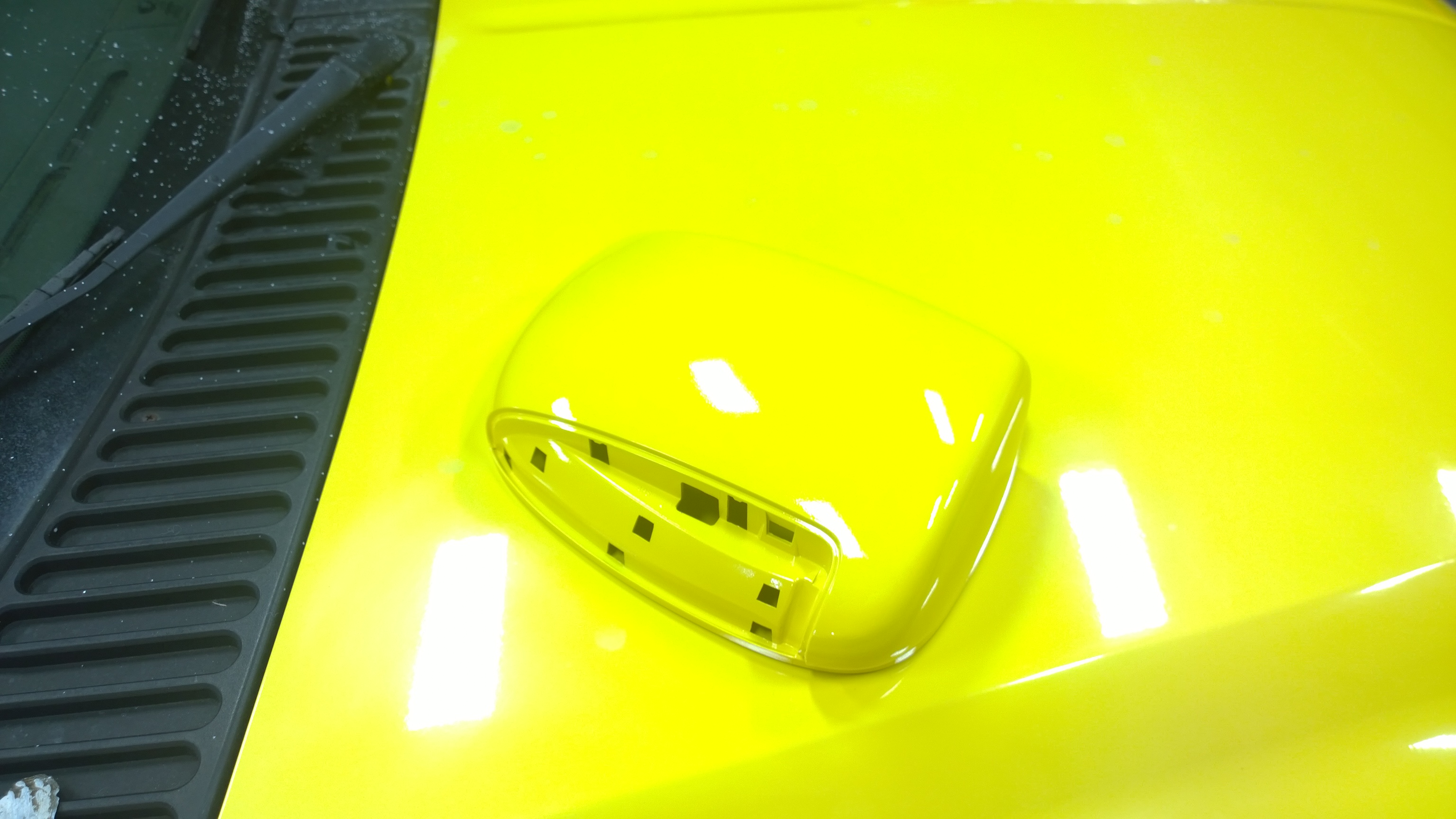

I used adhesive promoter then primer. I also use the same paint supplier as recommended above. Color was spot on. Just read the directions and prep. I did my grill and mirror caps, getting ready to do my head lights

Mine are paint matched and I sanded them down completely smooth then adhesion promoter and then primer. They turned out pretty good

A 12 oz spray can is equivilant to 7oz of paint. I did both mirrors and the grill with 2 cans of primer, 1.5 can of base, half a can(if that) of adhesive promoter, and 2 cans of clear. And thats with me ****ing up (wet sanded through the clear and the base) and having to re shoot one coat of base and the entire clear on the grill. I just followed the instructions on the can and the web site for the dry time and the number of coats.
