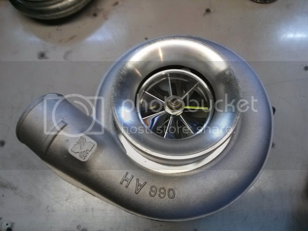

I just did a Google search. I have the billet wheel with race cover, 92mm turbine wheel and 1.1 (I think) turbine housing.
Like this one Chris??
I will let it rest after this Chris. Just trying to understand or figure out how it could flow those numbers. It has me scratching my head. Now if it was a 88mm I would see how but the 82mm do not do it. BUT maybe they are getting better. That would mean a quicker spooling compound set up.
