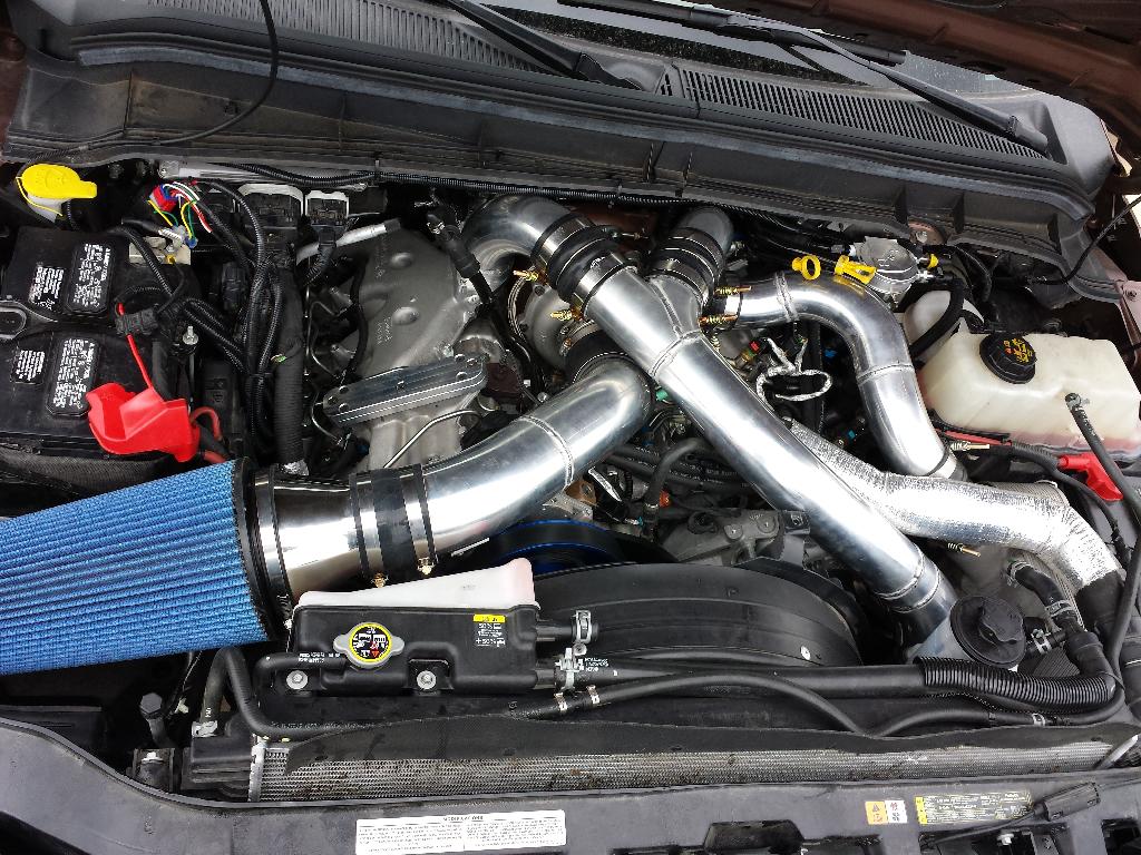

The Twin-Tube would be easier to do and work well with a '15 upgrade. The reason being is by going to the Twin-tube you also need to upgrade your air intake tubing. This is pretty easily accomplished with the '15 turbo with just the single inlet. We can supply an air intake pipe for the S&B or our large AFE filter.
With a stock turbo, when we replaced the stock intake manifolds (upper and lower) our peak power didn't change but at a lower rpm it gained a substantial amount of power, 30hp @1850rpm and 100 ft-lbs of torque @ 1750rpm. I did not record egt's before and after but they may have decreased because the airflow ability is so much greater. I did flow test the stock intakes versus the Twin-tube and those intakes are a huge restriction.
Here are a few pics.

gfulton
Mar 19, 2013
1,304
Eliasville, Texas
That sure is a purtty motor in that picture there :clapping:

I really appreciate the feedback regarding this kit. I feel that in order for me to want to go through with this kit that I would want to do a 2015 turbo upgrade at the same time. I think in time I will definitely be going this way as this looks like a kick ass clean setup! I can speak for myself and at least a few others when I say thanks for showing us the details regarding this kit!!

I love getting to see pics of the completed EDE piping setup! The photos offer an opportunity for me to preview the finished product in advance, and the photos also help me appreciate all of the hard work, money and effort that is going into this truck :)
More pics!!!
