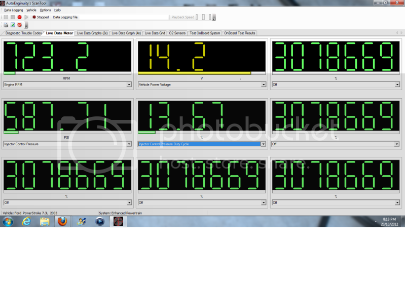

its been a busy week but managed to pull the engine and fix the pan. Sat nite and she fired up pretty much straight away. Will put the front end on 2morrow and take her for a spin. One question - Im reading 45psi oil pressure at the hpop at idle. Is that OK.

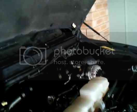

took a video on da phone just gotta work out how to put it on the pwuta.

I seem to remember reading in the ford engine manual that you should have 40-70 at 3300 RPM. I don't remember it specifying what idle pressure was supposed to be.
I do however remember seeing a significant difference in LPO pressure with cold oil, VS once it reached normal temps.
Are you checking hot?
45psi with cold oil is what I'd probably call normal.

reservoir Joe. AE shows the hpop. Heres a video. It was late at night so excuse the quality. let me know if it doesnt work

Yep that sounds just like a good 7.3 that just had its injectors changed out. Some air still in the HPOP side of the injectors and why the long crank time but everything sounds good. The first time the bang sound of the injectors tie from the HPOP not being completely air free I assume worried me but sure enough a few good drives and it was all smoothed out.
You should be happy you were able to build this all up on your own only with support from the forums. Great job!!!!!
