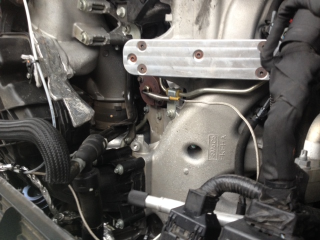

I hope these pictures help you out.

The flange that is bolted to the intake manifold where the boost fitting is in the last pic...is that something that was there or something that was custom made?
stevens6.7
Aug 4, 2013
573
Houston
Awesome man....that helps out a ton. Thanks a lot! Your gauges look great!
Thanks man I really enjoy them!
That came with my Absolute performance EGR delete kit. Came with the plate and both block offs.

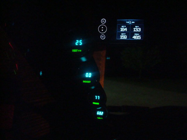

Yeah...I have my 6L and my buddy's 6L setup the same way. He really loves it and wants the gauge setup in his 6.7 the same way. This is how we both have our gauge setups with the edge insight up top where the mini maxx would be.
