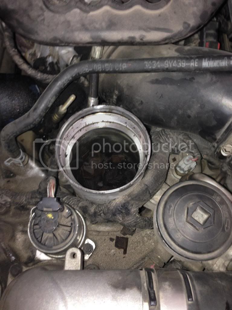

Alright guys I got the motor in and trying to start it. Should the oil pressure gauge come up after a few seconds even after the motor has been torn down? If it's suppose to move then looks like I have to pull the lpop to see if there is any damage. FML
It might not come up until the engine starts. Pull the oil filter and see if it fills up the canister while cranking

When we did injector jobs or anything in the hpop side of things the truck would fire up a second or two after the oil pressure gauge on the dash moved. If you did take anything off the hight pressure oils side of things it's gunna take some cranking to get any air out of the system

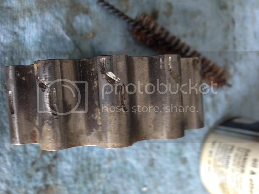

Well guys I put in new lifters and new lpop and its still not getting any oil to the filter. I pulled the regulator and the spring looks good. Pulled the engine back out and pulled the oil pan back off and the pickup tube was still on and tight. I don't know what to do now? Anyone have any suggestions?
Irontx
843
Texas
Was your front cover damaged/gaulded when that lpop checked out?!?!
