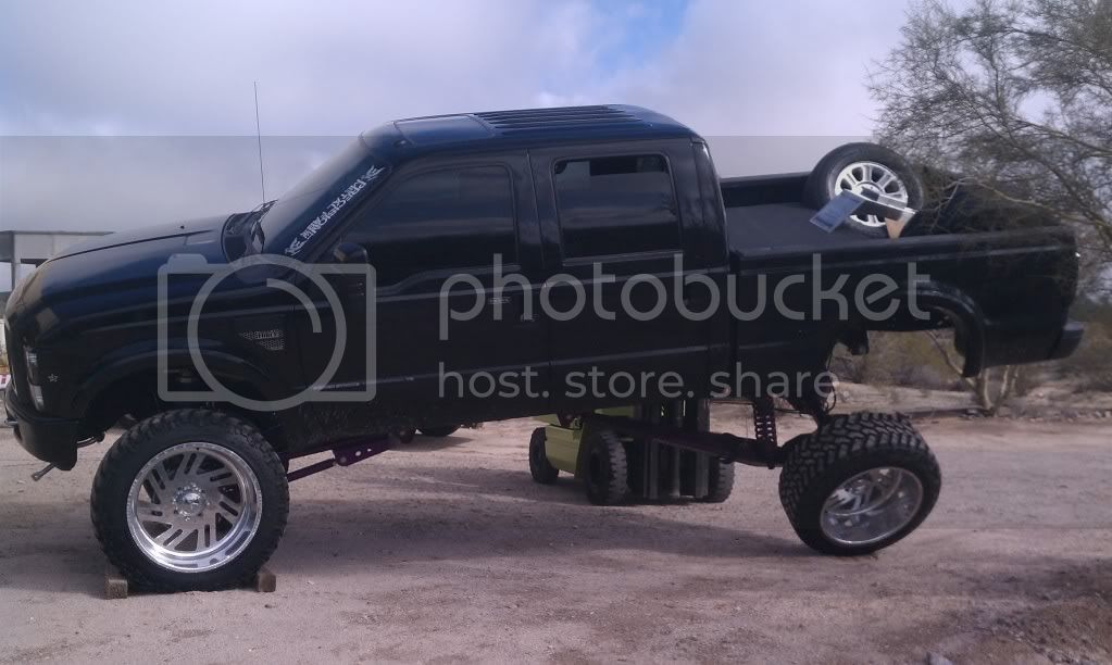

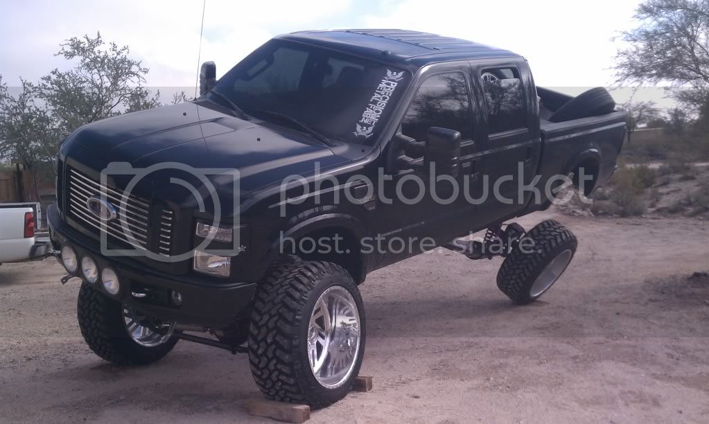

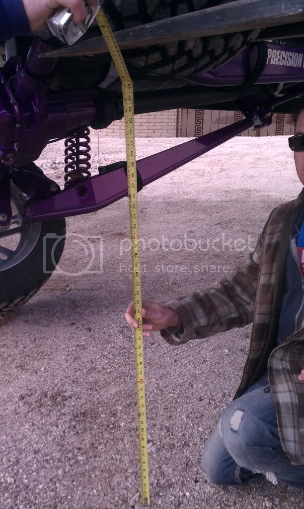

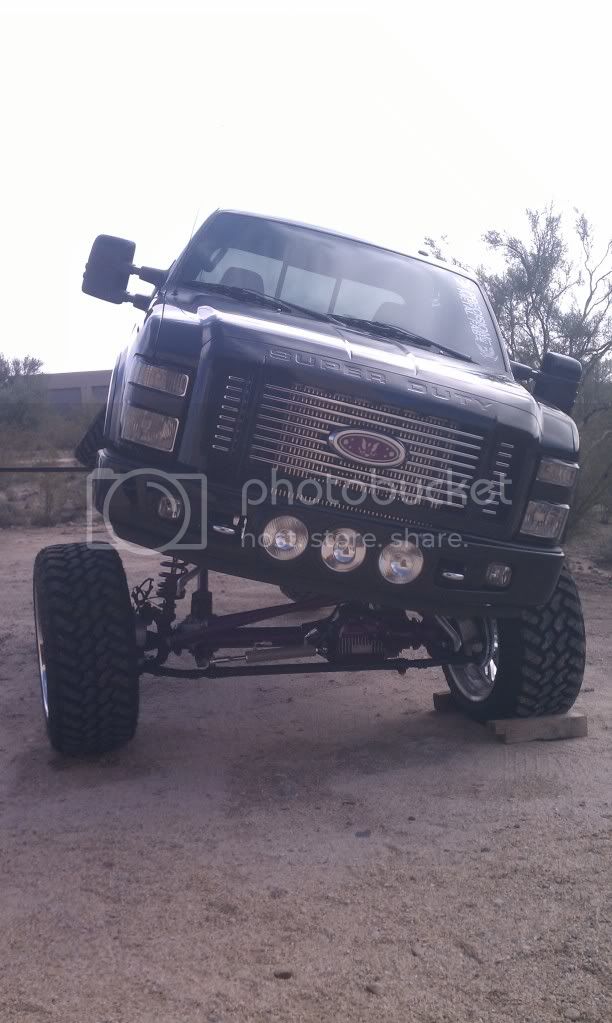

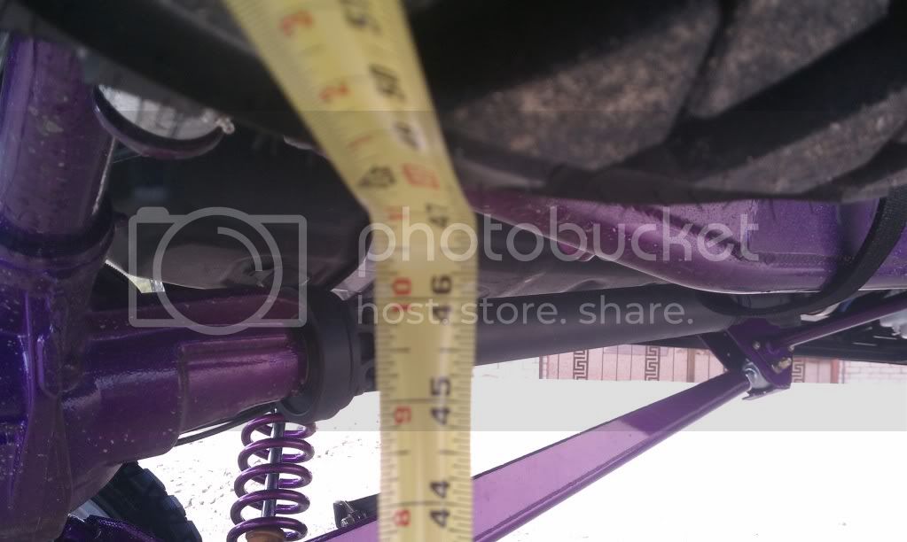

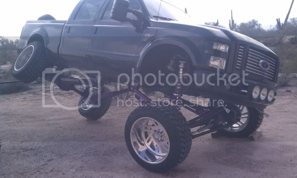

Ok, we havent really had a chance to get any good pics of our setups in action. This is one thing Im trying hard to work on. I just never have spare time to spend taking pictures, there is always something else to build. Any way, here are some pics of our newly designed 10" long travel lift. It features 12" of front travel and 18.5" of rear travel. No bed or frame modications are needed. This particular kit was built with 3.0 dual rate shocks but 2.5's could be used to make the kit more affordable. The rear is setup with a trophy truck inspired trailing arm that could handle anything you wanted to throw at it. If anyone has any questions, just ask!
And yes, thats 48" of articulation and still had a bit left in her...
