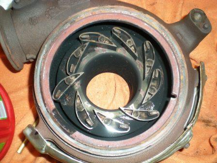

no prob man
it's a variable geometry turbo.
http://powerstrokearmy.com/forums/attachment.php?attachmentid=9907&stc=1&d=1348797108
I'm no expert, but your turbo has veins inside of it to change the size. It's smaller for quick spool up and then veins "open" to push more air. Something electrical could cause the veins to stick open or soot build up could cause them to stick open.
Have u ever noticed when you first start your truck it sounds like a big block v8 then a few seconds later it starts to whistle? that's the veins closing and causing that.
Just throwing out ideas trying to help.

What if the veins are stuck? Easy fix or does that mean turbo is shot?

Oh, I thought it was a 7.3, check the EBP sensor, if that is not the issue, then pull the turbo, and see if you can clean the vains, and such. If still no good, new turbo time. Happened to me
