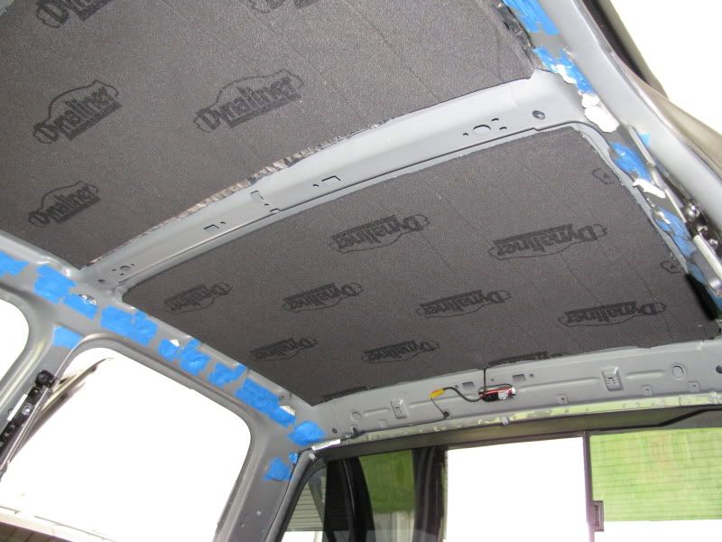

You say foam filler but I was hoping you could be a lil more specific? I looked at some of the foam fillers at the hardware store awhile back when thinking about this and there seems to be a few different types with different effects from each.
You can use the Great Stuff products normally found at the hardware store, just need to be a little bit more careful with them and leave room for expansion. You want to fill maybe half the cavity with the foam then allow it to expand, make sure to form off most of the holes with some tape so you don't have a total mess to clean up and keep an eye on it to keep from messing up other spots.
This is in a cummins but gives you an idea of how we filled the voids over the doors. Covered most of the holes with tape and left some room to get the nozzle in along the way, then carefully pumped some foam in and allowed it to work.
