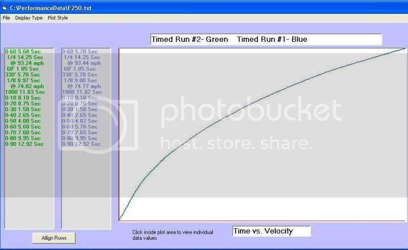

My truck, 100% bone stock except a x-race tune from Eric did 466/772 on a Superflow AutoDyn SF-840. Every Dodge that ran that day was crying their numbers were low and mine looked way too high. Torque seemed about right, hp a touch high. When I say stock, I mean stock air filter, cat and muffler both still in place.
I ran 1/4 mile with a dash mounted datalogger on 34" swampers with my x-street tune and did a 14.25 consistently (ran it a few times) and it calculated RWHP to be ~423.... That seemed more realistic.
Here's my 1/4 mile sheet... 2 runs, right after another. Again, this is on x-street, 34" super swampers, a passenger and a toolbox full of crap in the bed.
