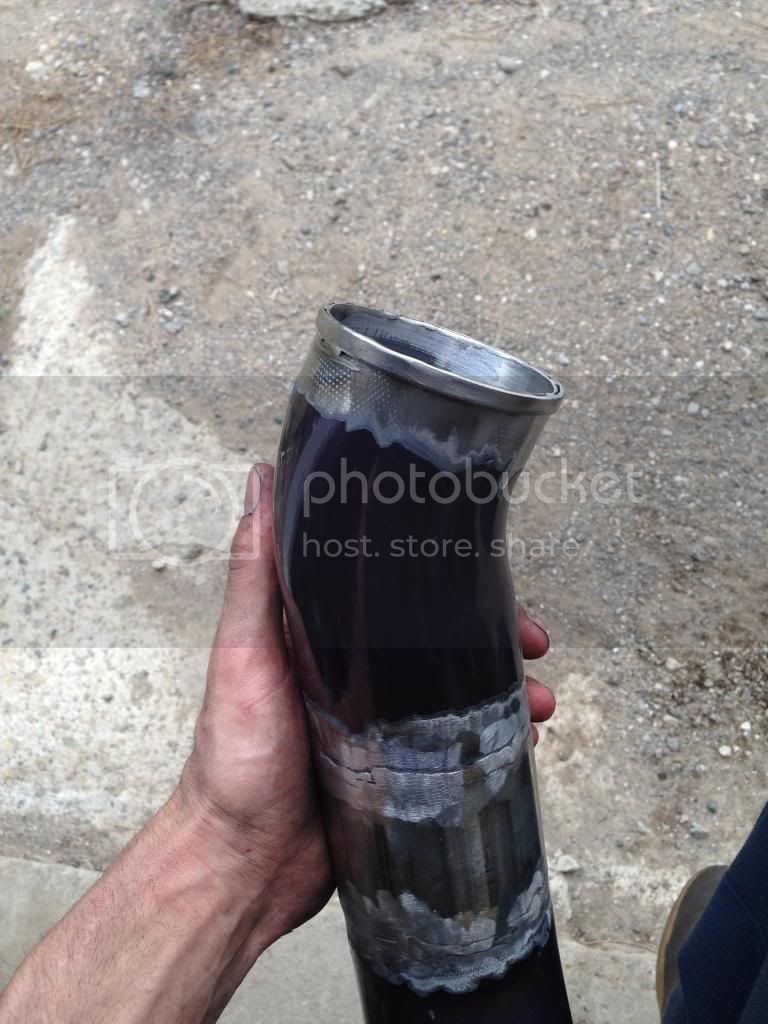

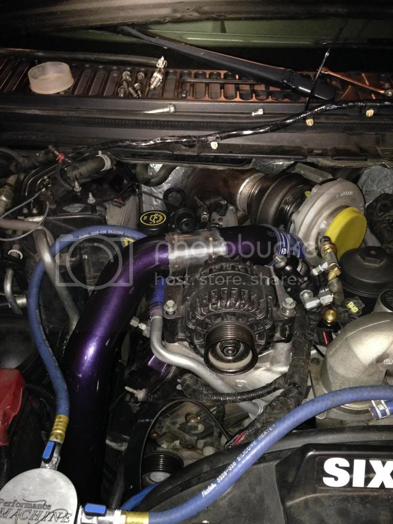

Here they are, all i did was cut the 2.5'' reducer section off the stock ic pipe, then cut the ic pipe a little bit up in a straight section and added i think 3'' to it and just rotated the elbow part to meet up with the comp housing outlet.
Once i did that i cut a piece of 3'' pipe about 1/4'' thick and welded it to the very end of the pipe for something to stop the boot from sliding off under boost. After i did this i blew up the stock intercooler since it couldnt push this boot off anymore lol
