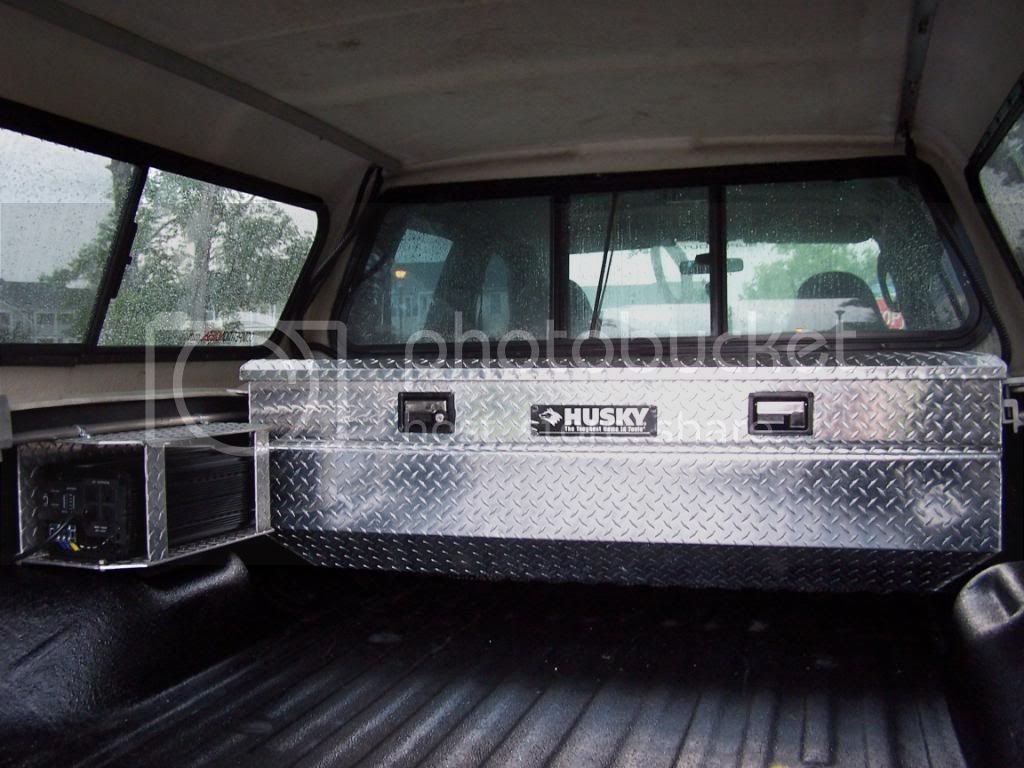

I run a Wagan 10,000watt peak inverter...

That's a real slick mount you have setup there in your bed Tank. I have no cargo top, and assume I would want to exterior mount this inverter due to heat, so making a closed but ventilated box for my bed is prolly going to be the answer huh? I'm not worrying about fabbing anything up as I can handle that aspect. Thanks for all the info so far guys. Keep it coming!

Thats awesome Tank!! Anyone mount a small one in the cab, maybe under that passenger seat? Our work vehicles, Crown vics, get one mounted there to run some of our equipment. Wonder how it would do in the trucks?
