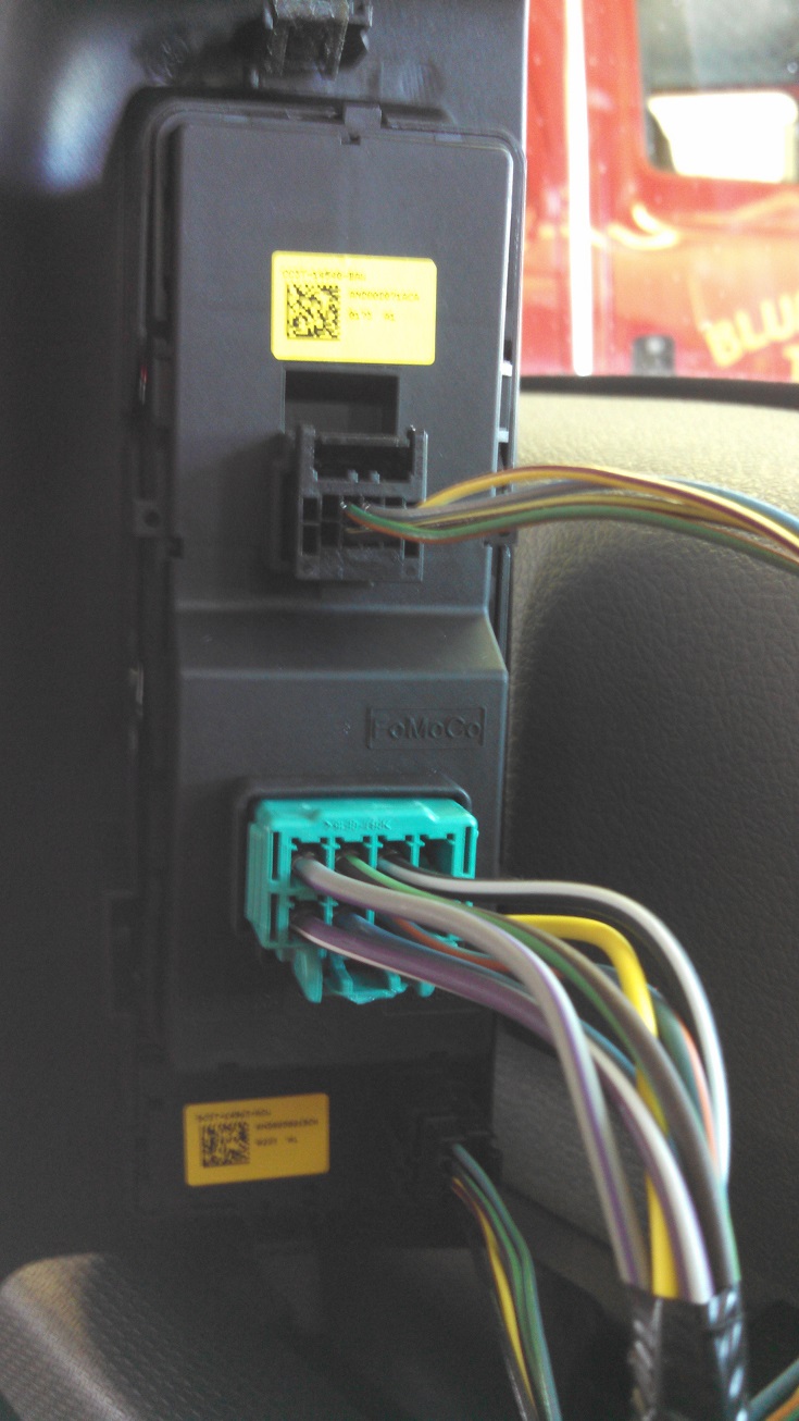

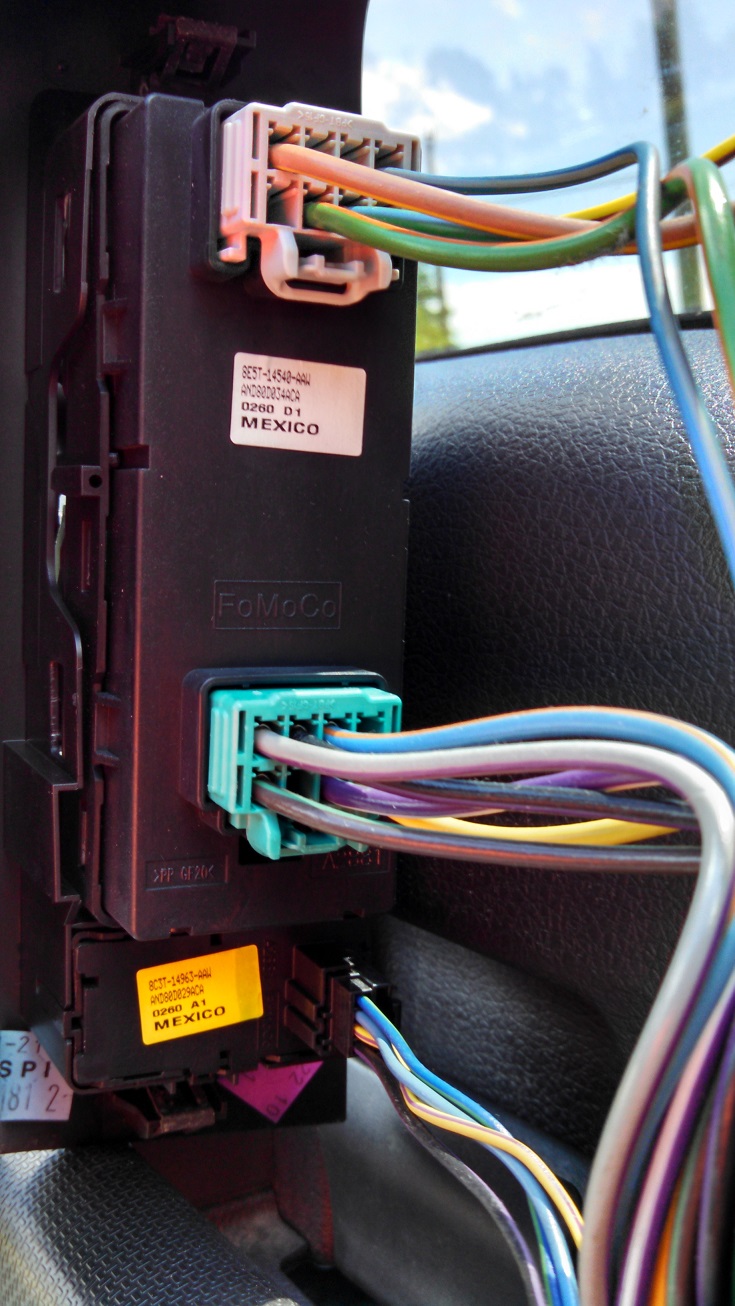

Here's an update. Took apart the door switches on my truck and a newer truck today. The bad news is it is NOT a plug and play operation like I'd hoped. Maybe a Ford tech or someone a lot smarter on this than me could help us out. Would really like this option but not going to jump through a lot of hoops or spend a ton of money to do it. The picture with the 4 small wires is from the newer truck. The other one is from my 2010.
