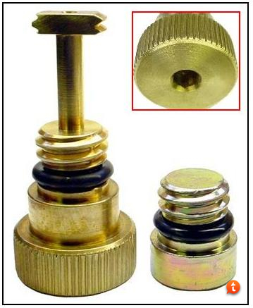

The plug is a 6mm. You can buy the hfcm manifold gasket kit and a new wif sensor (or you can clean the old one once it is removed. Just be mindful to not tear or knick the o ring on the sensor). Pull the housing off, tear it down and clean it thoroughly. Reseal it using the gasket kit and pick up an lcf drain plug while you are at the dealer getting the other stuff.

I had the same problem. Use a bigger Allen wrench and hit it with a hammer to make it stick. Once you get it out go buy the innovative plug that you can hand tighten.
