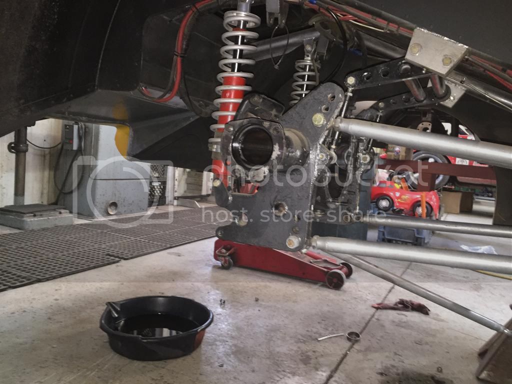

this is pretty much how the headers are going to have to run. they have to go on the outside of the support tubes but inside of the strut and not get in the way of the tire when it is at full lock. The turbo will be oriented with the T6 foot facing back so the outlet can go right into the low pressure.
tans in installed and tube work being finished up. interior is going to be completed before I pick it up to do the turbo stuff.
