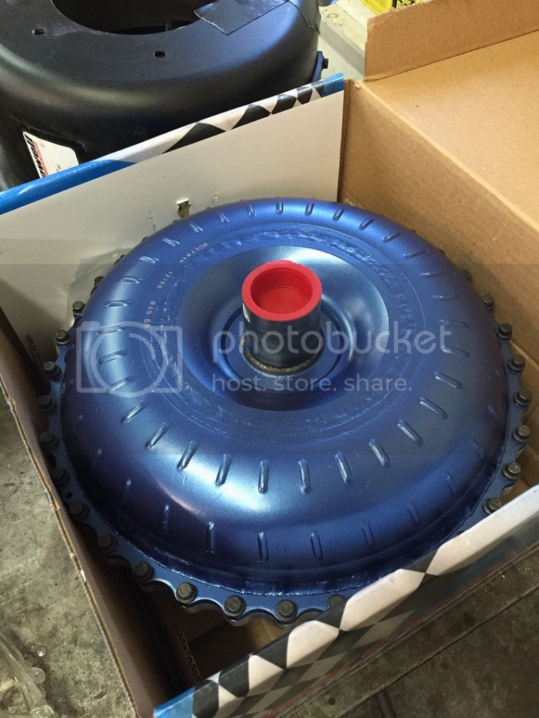

Convertor got hand delivered on Friday. Bruno drive is in Texas getting the lock up fixed. And the fuel cell and oil tank are being fabbed up currently. Still on track for the NHRDA season opener for debut.

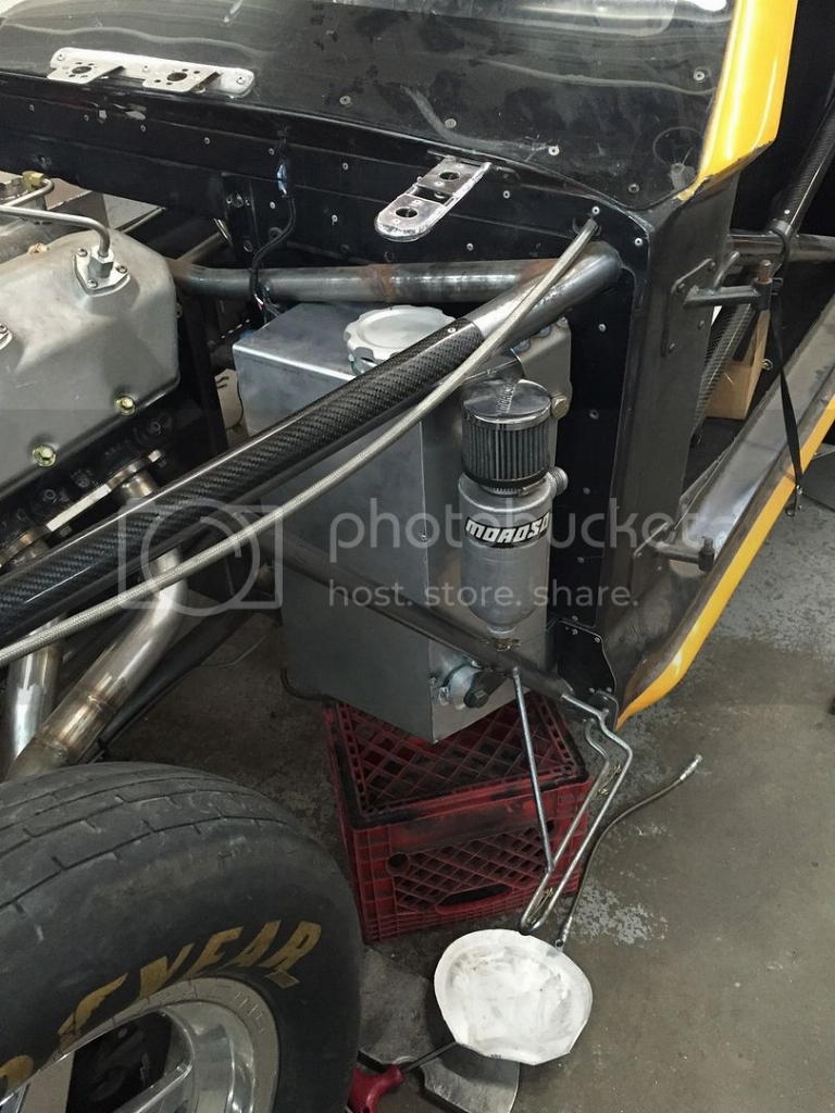

Went to Holzmans today to pick up some tubing for another project. So I have an update on the mustang. The oil tank turned out awesome. Love how it's slim and out of the way but still holds 5gals.
