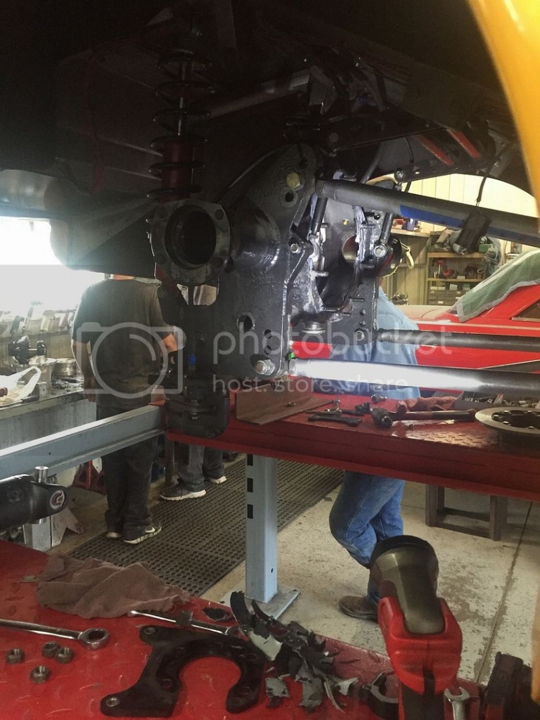

Sorry guys been non stop late nights and early mornings lol. I'll try and get some pictures and videos up today.

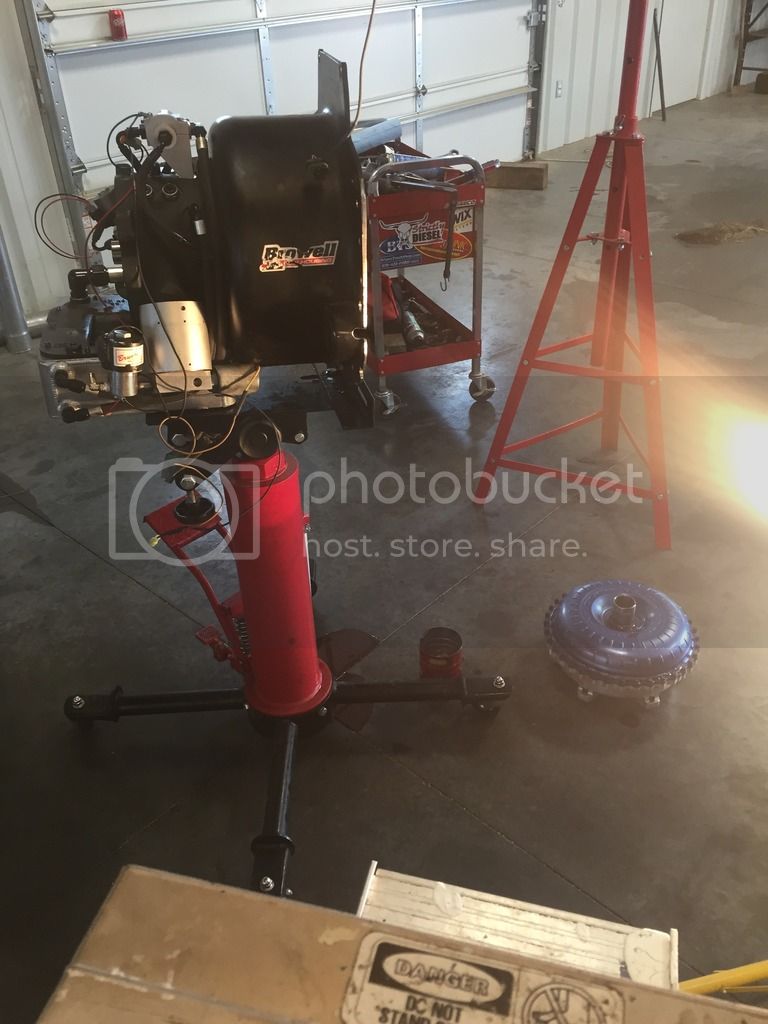

We had a few problems show up Friday that killed our chance to run it. TC clutches locked up and bearing in the 3rd member locked up. Got the 3rd membe fixed late Friday and Saturday morning at the track we made it where we can drive it by playing with the TC pressures and broke the beams in qualifying so we were for sure qualified for world finals.

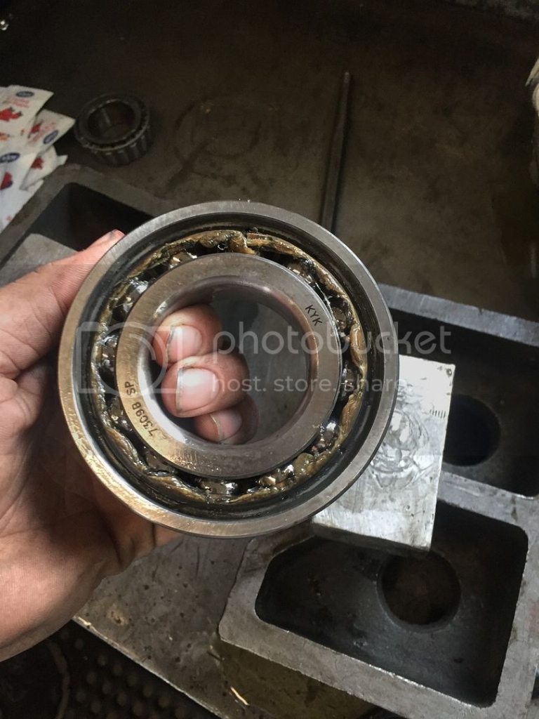

Hat bolts on the roter were hitting so we machine a spacer
Then we heard grinding in the rear end and found this.

That'll work too. Timken is good stuff for sure. For ball or spherical roller bearings I prefer SKF. Any tapered roller bear, Timken.
