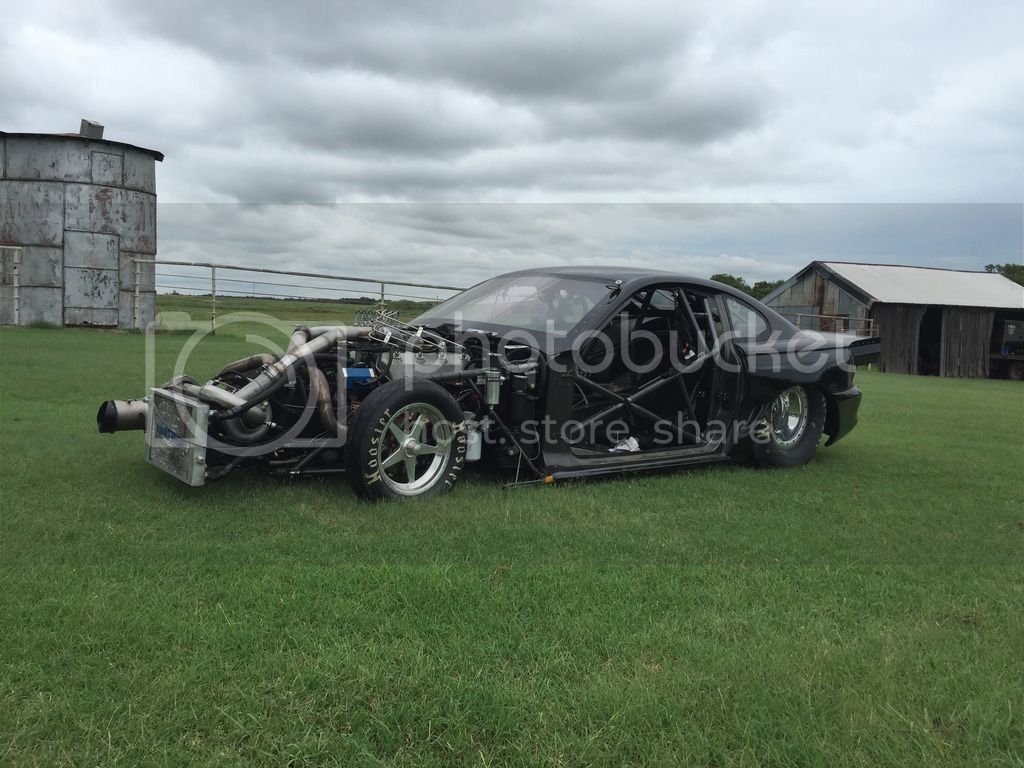

that was about 20 psi. just testing components not trying to break records or anything. Track couldnt hold any power that night anyway. We spun the whole time I was on the power on that soft launch anyway. Brakes arnt holding it and making it hard to stop so I didnt want to get going to fast.
when it first leaves and doesn't go very far is because there is a default delay on the trans brake button that we didn't take out and I let off the foot brake and the trans brake at the same time and since the trans brake has a delay it didn't release right away so it crept with no foot brake then the trans brake released and that's when it started chirping the tires.

Brakes work great now with new components. We have our local track rented all day for Tuesday. Hopefully if all goes well we will have some Full passes.
