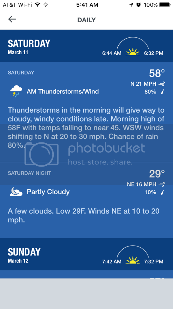

those winds alone are bad enough let alone the rain.. dam! I hope it straightens out for you!!
