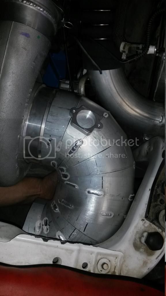

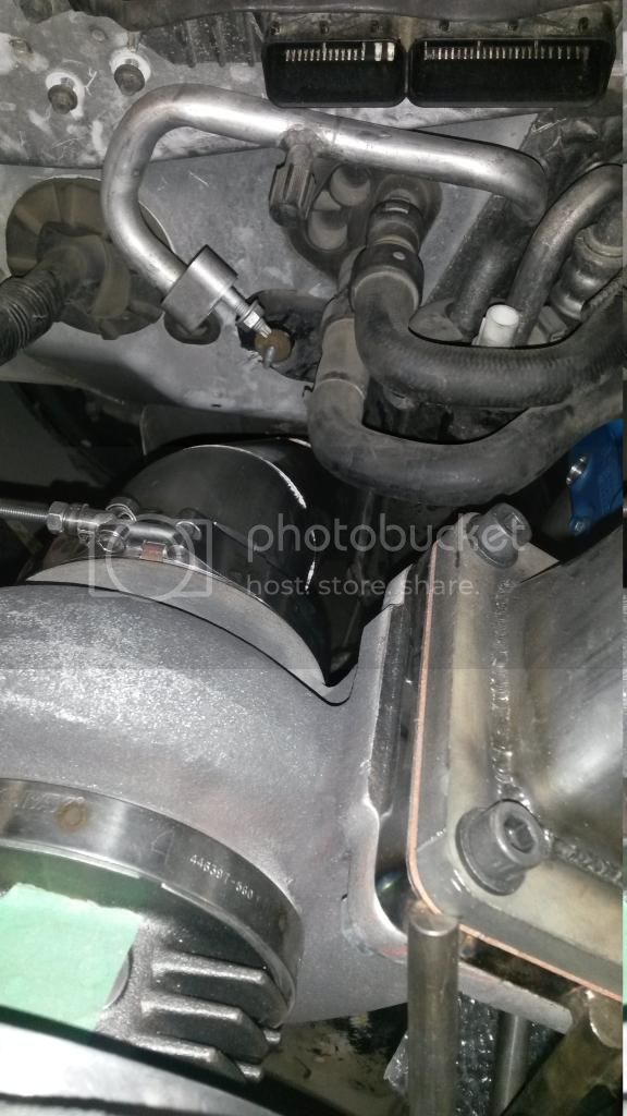

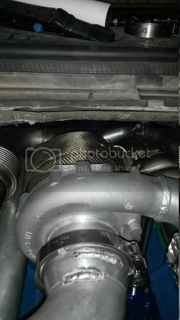

One turbo blanket arrived today, all the heat wrap and a washer fluid bottle too. Also tacked up the intake, just waiting on the 6" vband assembly and my air filters. Next step is down pipe and exhaust, all vbands and 304ss. Here's a couple pics.

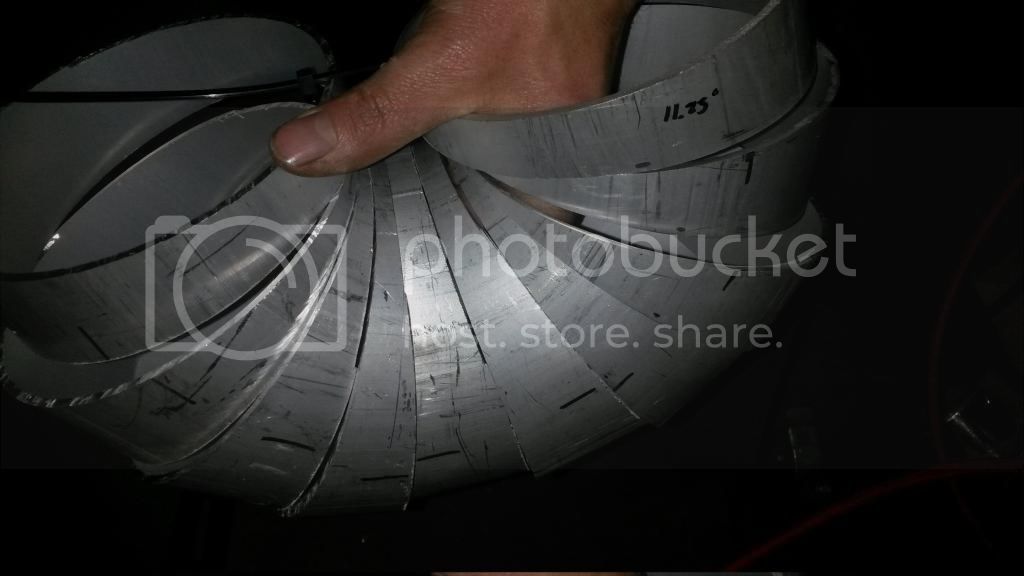

Looking good Shane, those pie cuts in your 180 degree bends are wild. Looks time consuming and verve damaging. LOL

That 180 was made from straight pipe too. Took some time but I think it is worth it. Might even get a good chunk of the down pipe started Monday morning, see how tired I am after nights and swapping the winter tires onto the wife's SUV.

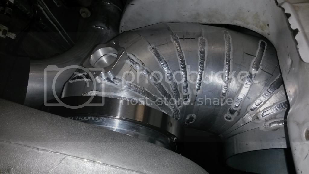

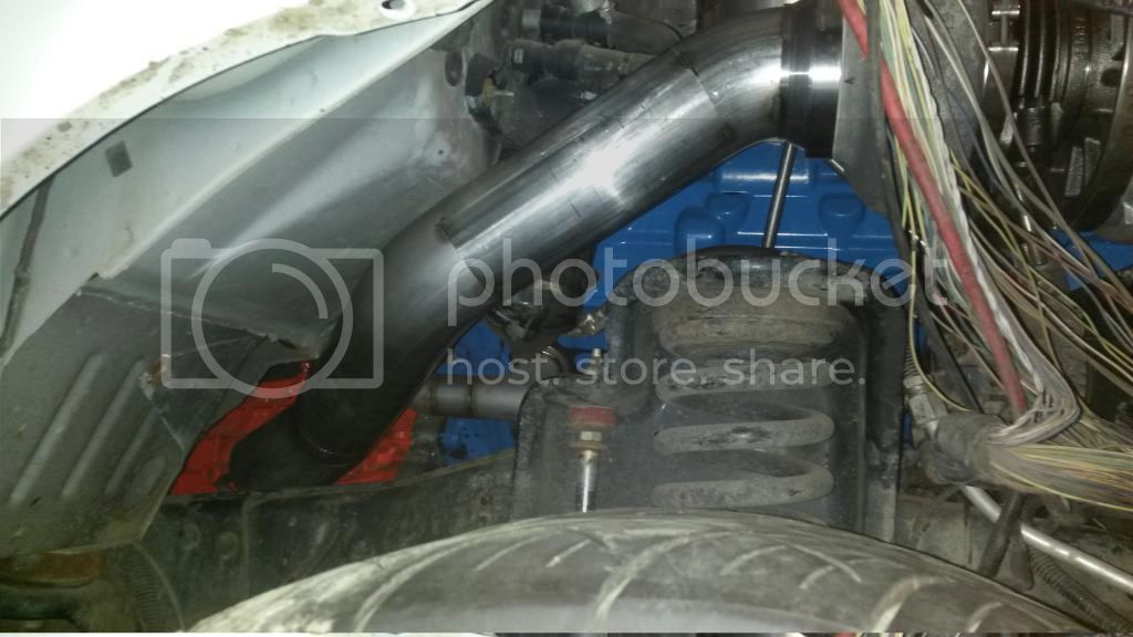

Down pipe is tacked up. Fits pretty good. Hope to build the exhaust tomorrow.

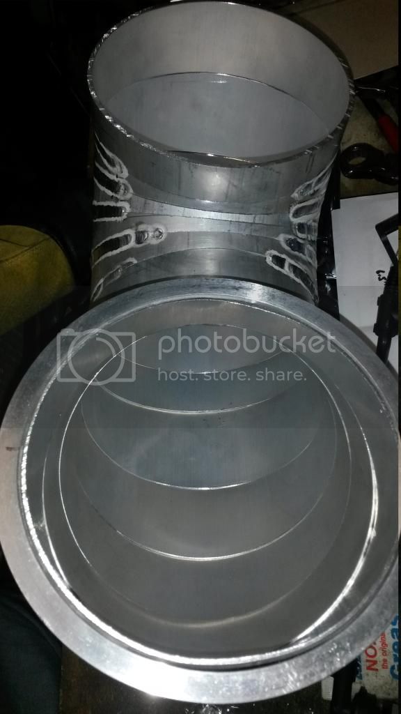

Vband for the intake arrived and here it's mounted up. Shot of the inside of the intake as well, filters on route from afe.
