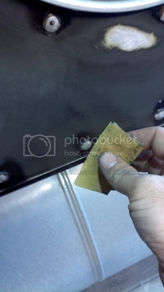

just a tip for sanding around rivets like that. take an old DA pad. spray it with 3m adhesive. then take a red scotch pad sprayed with adhesive on one side. stick it on and cut it to the size of the DA pad. worked GREAT when we painted UPS vans all the time.
Paul@CP_Trucks
2,581
Jasper, Texas
Dayum wish I had known about that two weeks ago...LOL
Thanks for the tip will come in handy on the next truck....

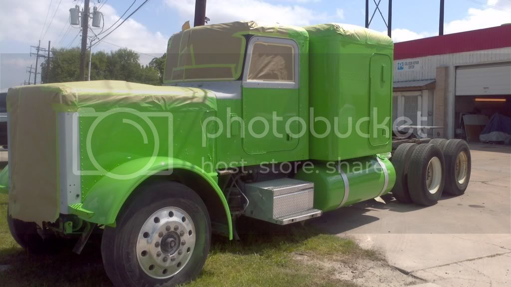

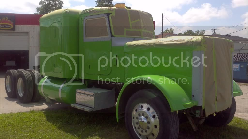

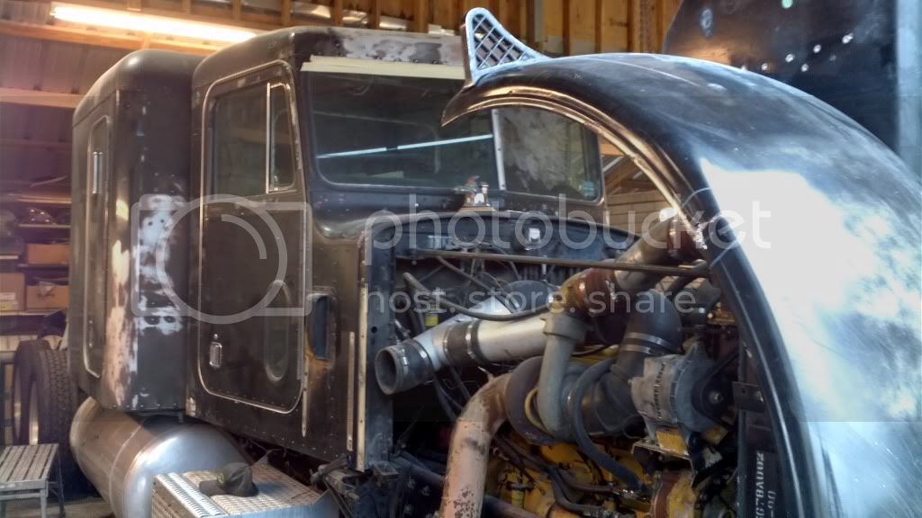

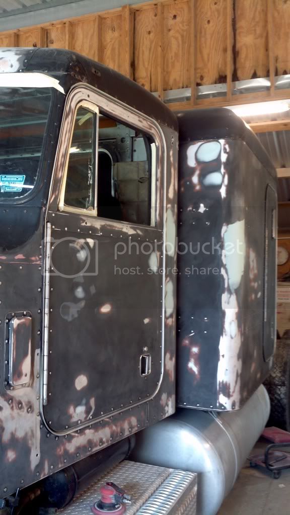

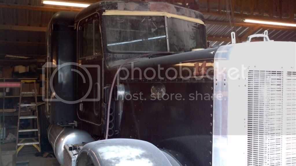

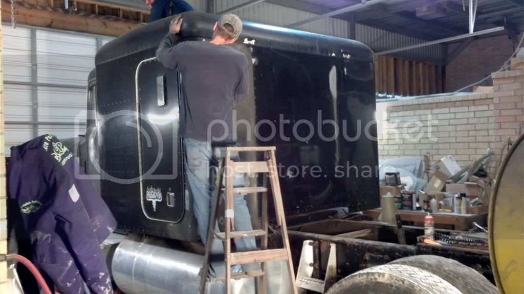

Lots of work the last two weeks...
$1100 worth of supplies:redspotdance:
Painted Engine..

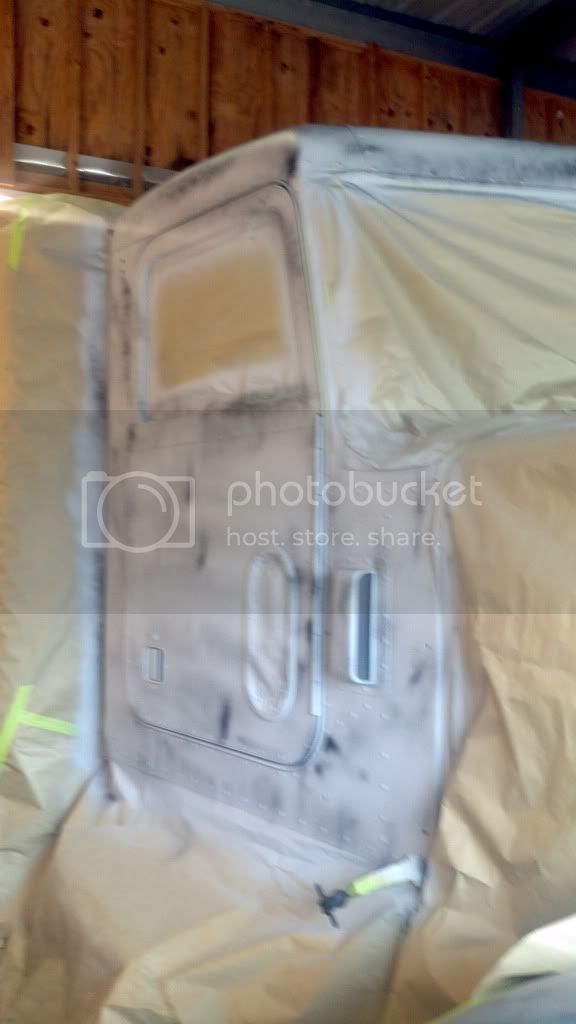

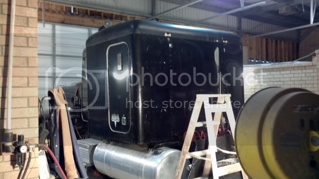

Black paint on the hood...

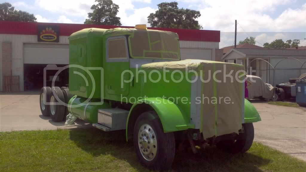

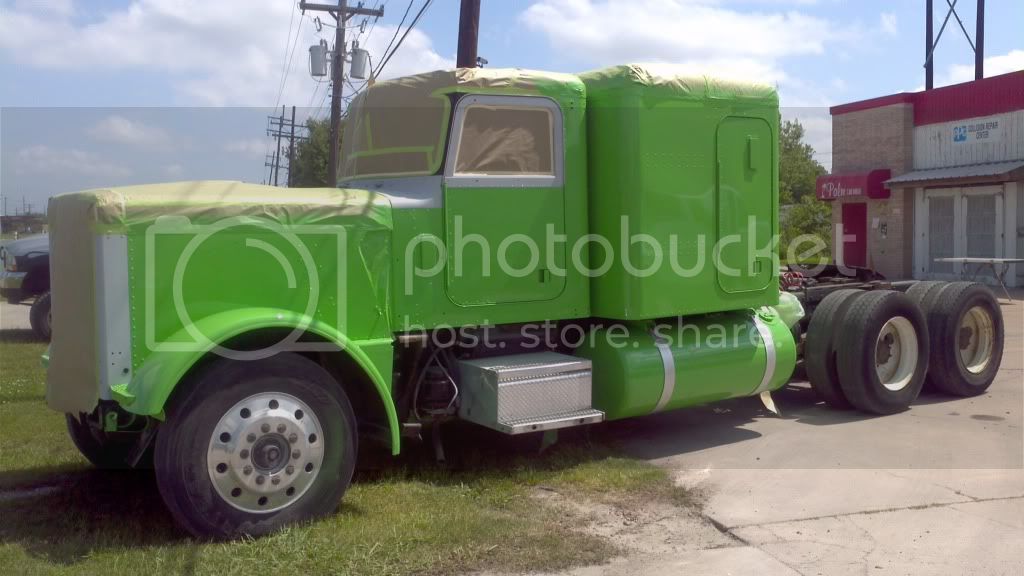

Getting ready for the green...
