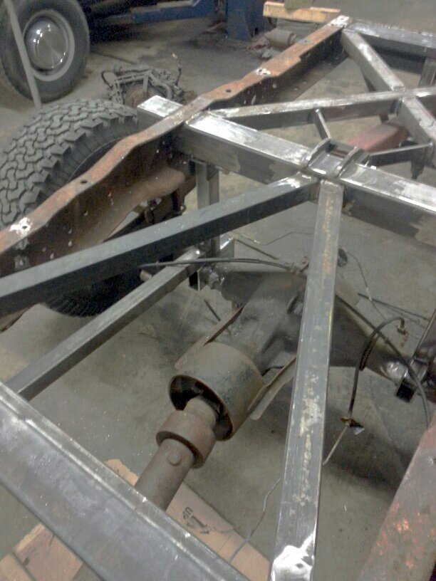

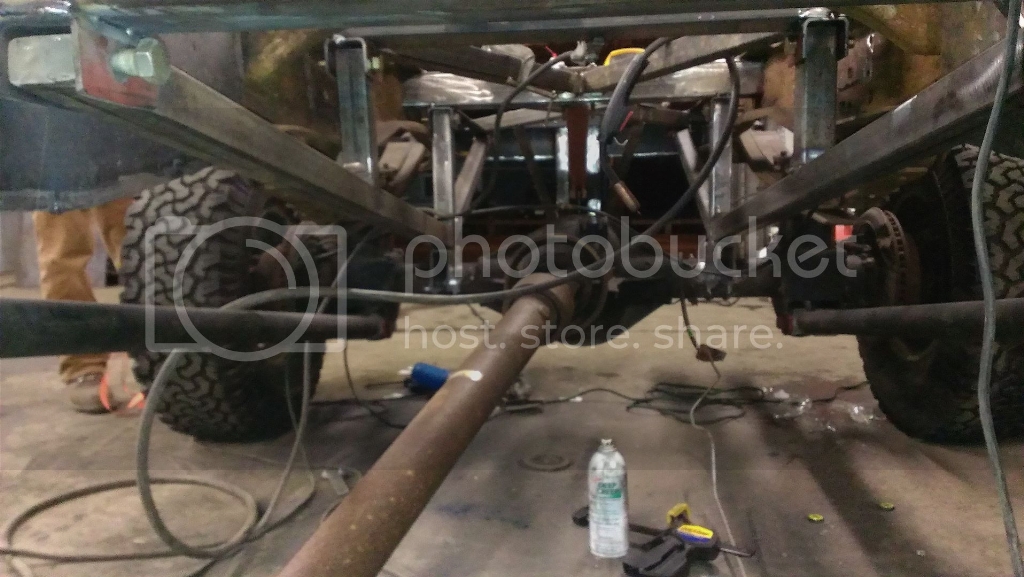

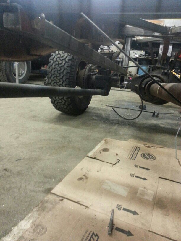

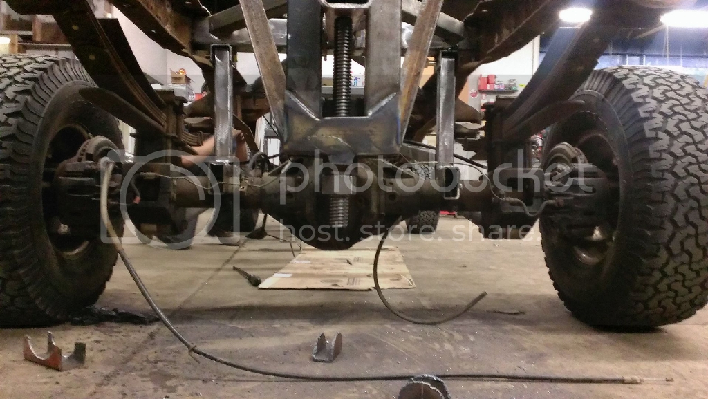

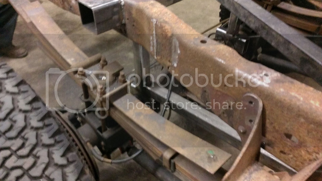

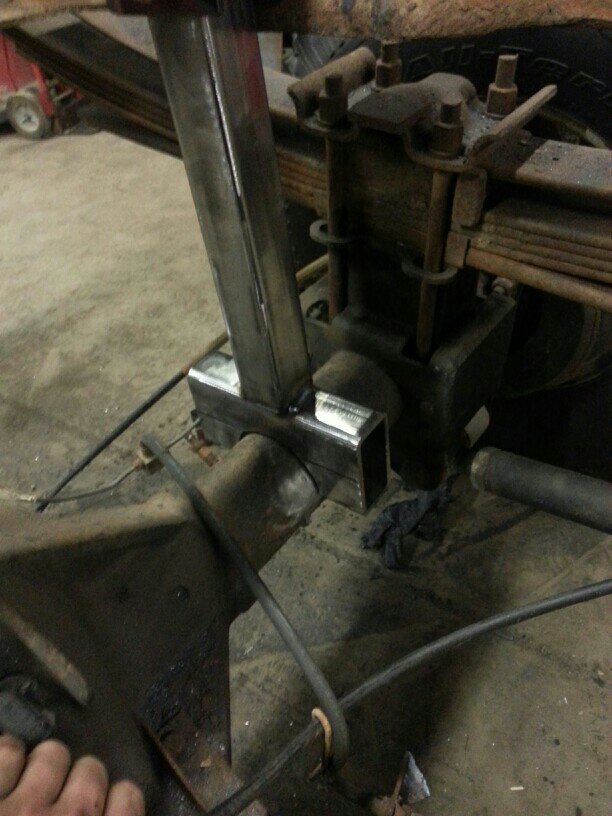

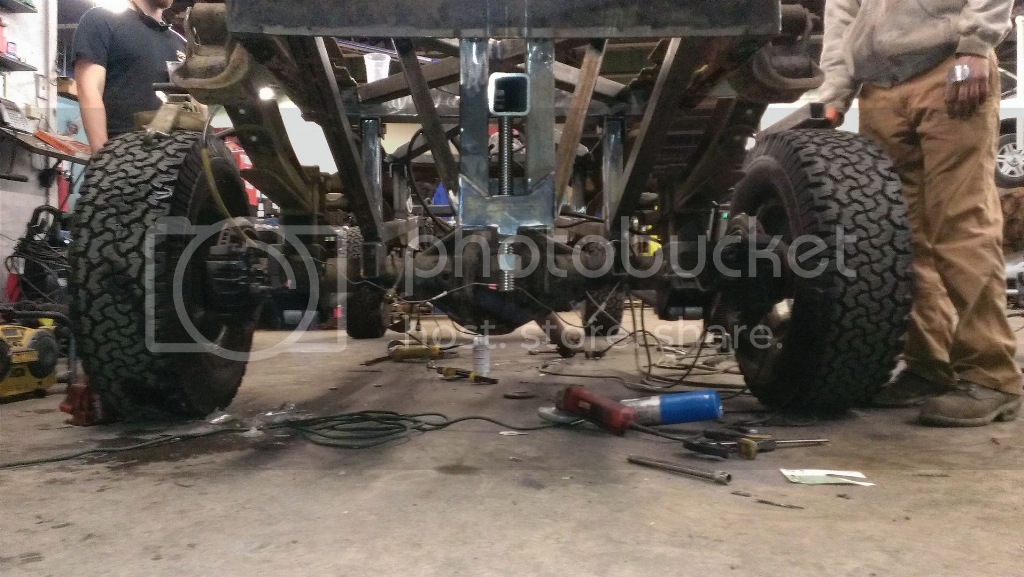

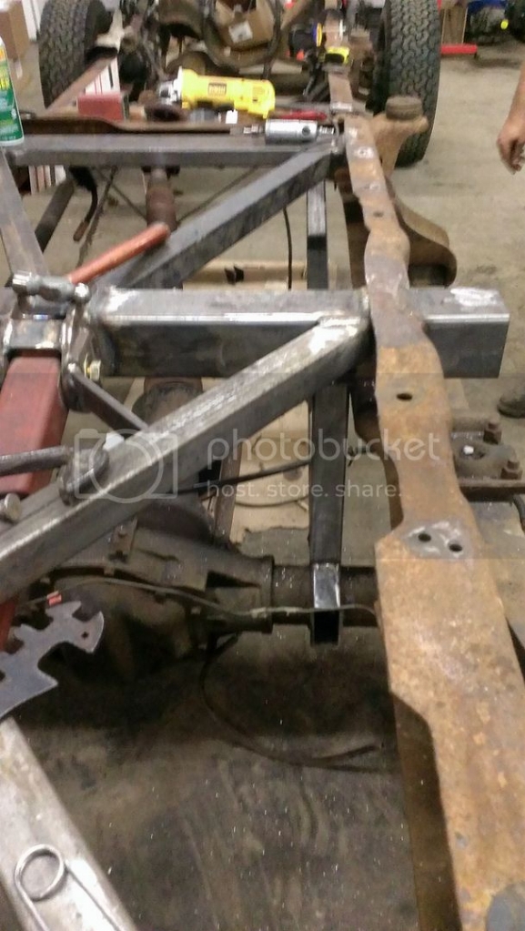

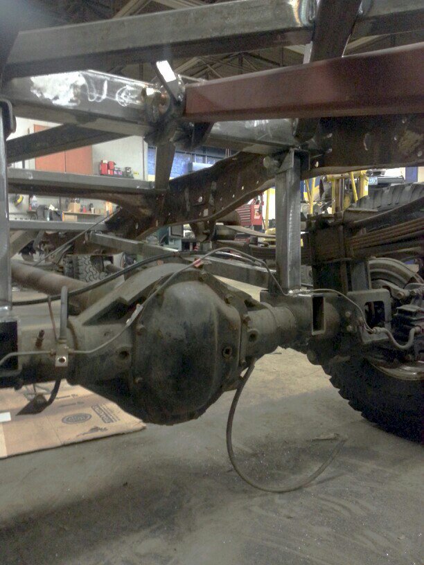

Made some progress tonight. Started getting the lower truss/suspension stops in. There will be another tube going backwards to the rear of the frame. The axle will be bolted solid to this.

This is the finished hitch adjuster. It still needs finish welding and grinding but you get the idea. It is 1 1/8 inch acme thread.

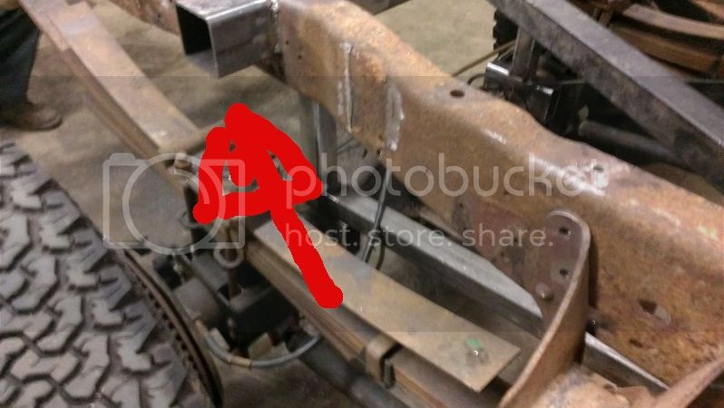

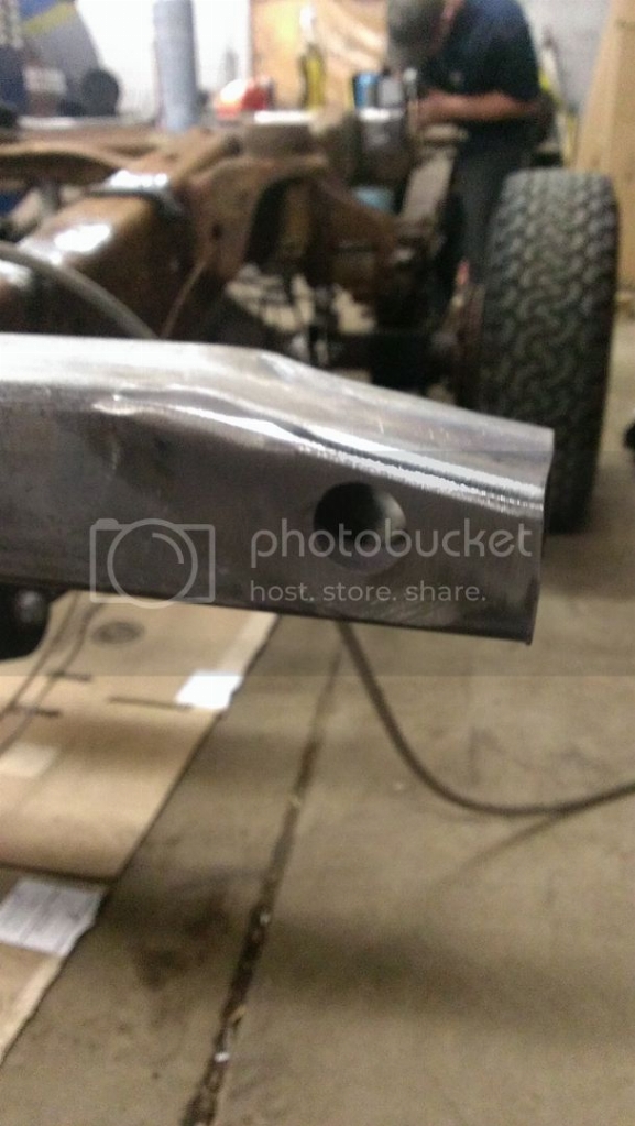

That is just the end of the 4x4 tube that is the main cross member for the draw bar. we cut the frame and slid it threw. It may get trimmed or left like that haven't decided yet.
