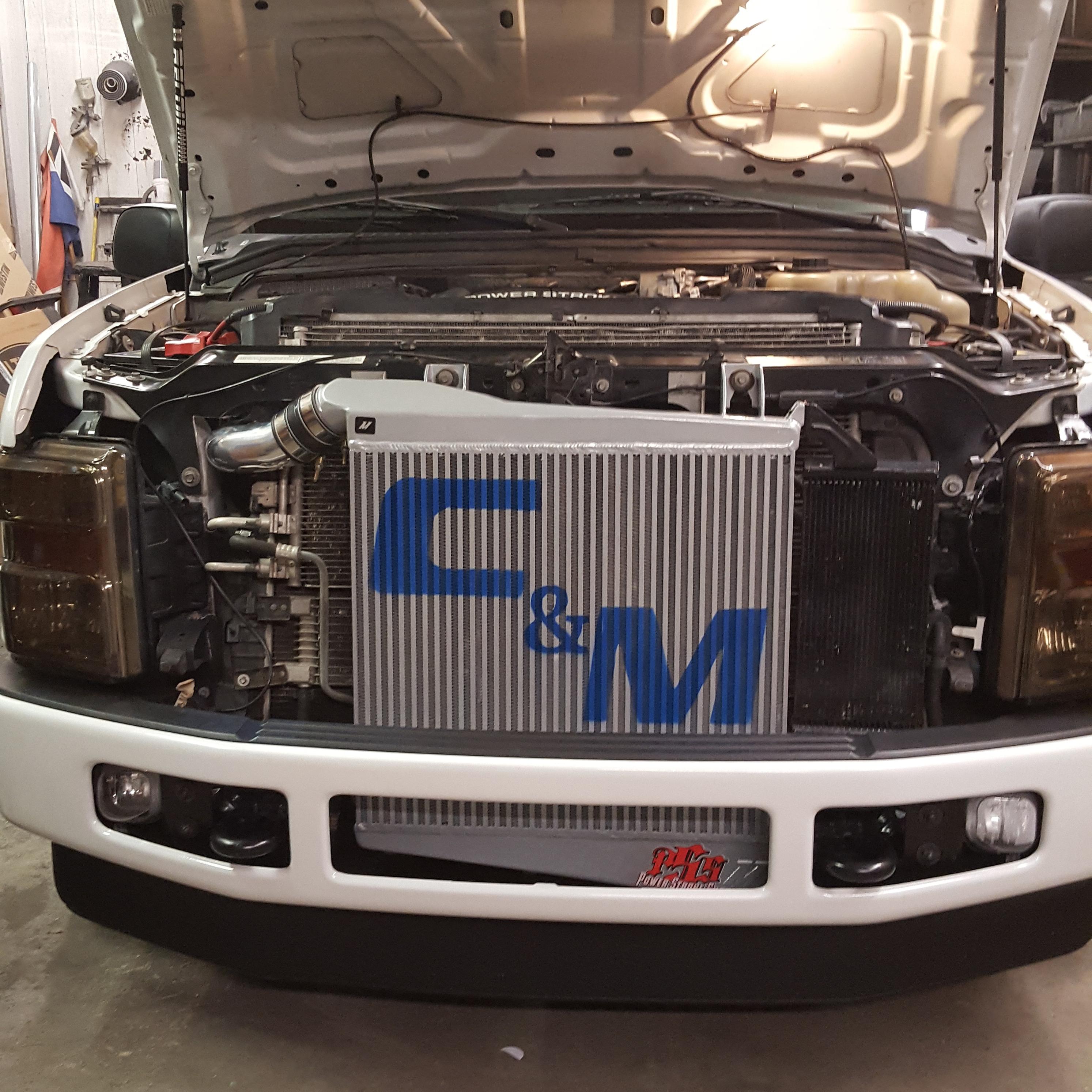

I installed my mishimoto intercooler and pipe today. Pretty easy install. Looks cool if nothing else. Will post some pics later.

Heres a picture of the new intercooler. My son and I put my company name on it.

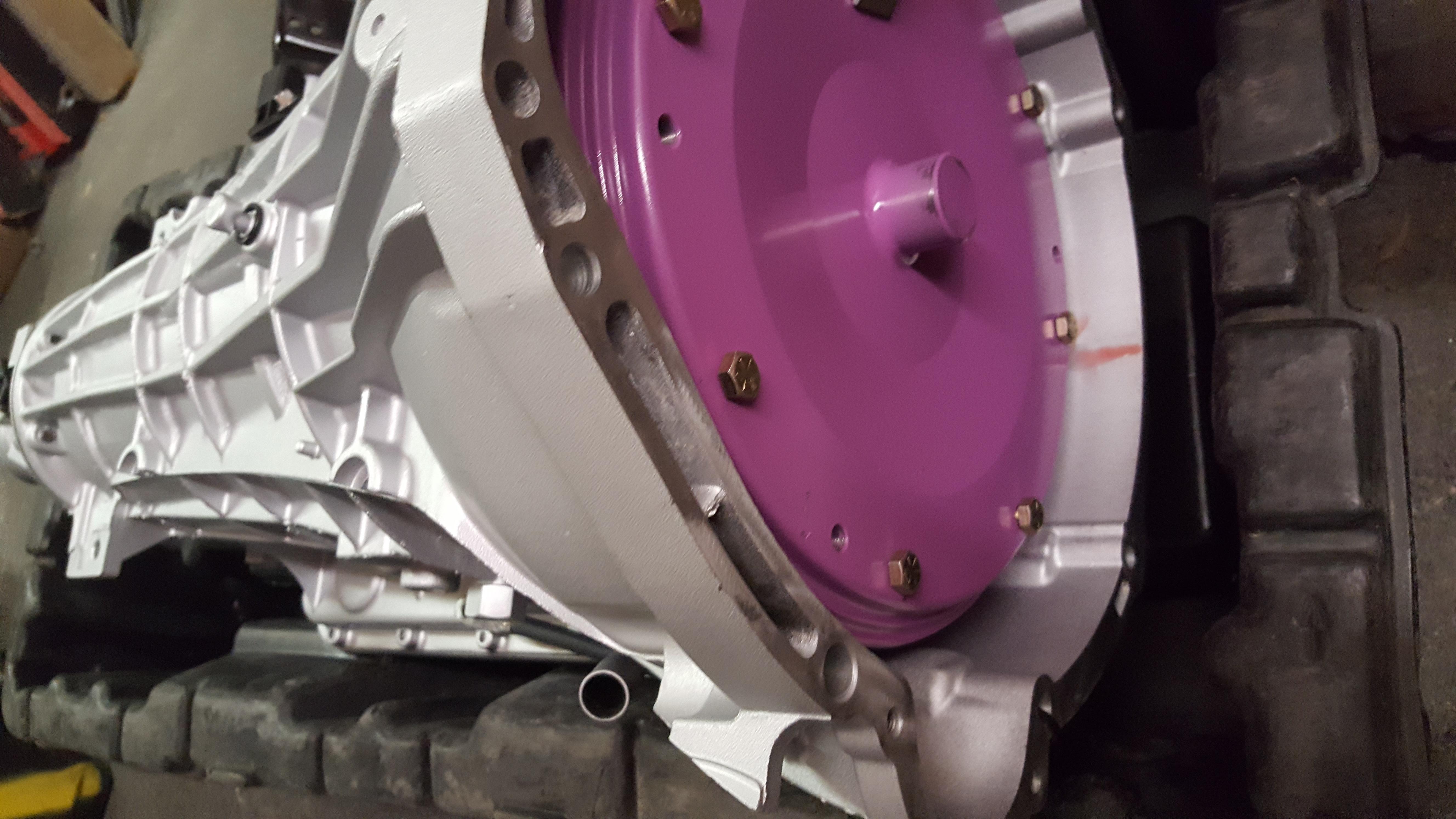

Well its a work in progress for sure. I just got my trans in today. Bunch of billet stuff, precision industries converter, and all needed upgrades inside. Also having to replace/add ground straps for this trans warranty. First Ive heard of ground problems but hey what do I know. Cant wait to get this beast in this weekend.

Alright guys tomorrow is the big day. I'm gonna put this transmission in ....or at least attempt to lol. I've got my fluid, trans jack, truck lift, new ground straps and hopefully all needed tools. Anybody got any last minute pointers to make this roll smoothly. Any help is appreciated. The converter came in the trans w fluid in it. I read thru the install sheet that came w it and it seems pretty straight forward. Thanks in advance:thumbsup::thumbsup:

Yours is a breeze because it's 2wd. Make double and triple sure the converter is seated properly on the pump gear before assembly or you will be pulling it out again. Bolt the case up and pull the converter to the flex plate with the bolts.

Prior to pulling the converter to the flex plate like sootie said, grab a stud and make sure the converter can turn. It has enough play to thunk thunk against the hole in the flex plate. That will ensure it is not bound up, like not fully seated in the pump. Also, do not pull the case to the engine using power tools. If it doesnt slide together smoothly at first, use something you cant put too much torque on to walk the trans to the motor. Sometimes the dowels are a bitch, but if you force it you can break the trans case, crush the pump, etc. Just go easy and it should be good. I use my 1/4in screw gun with the clutch set on 3...

The converter came installed and the builder said it was ready to be bolted in. I cant get my fingers behind the converter. The install sheet gave a measurement from the face of the bell housing and its there. The converter has 8 grade 8 bolts loosely in it ...I guess these are used to attach to the flex plate at 30 ft/lbs. Do I use lock tite?
