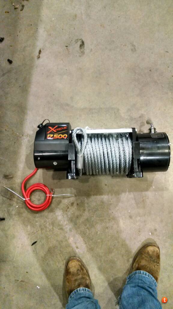

Winch showed up today. Damn this thing is heavy. I guess we'll see how it holds up.

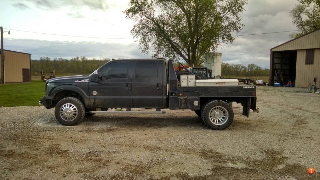

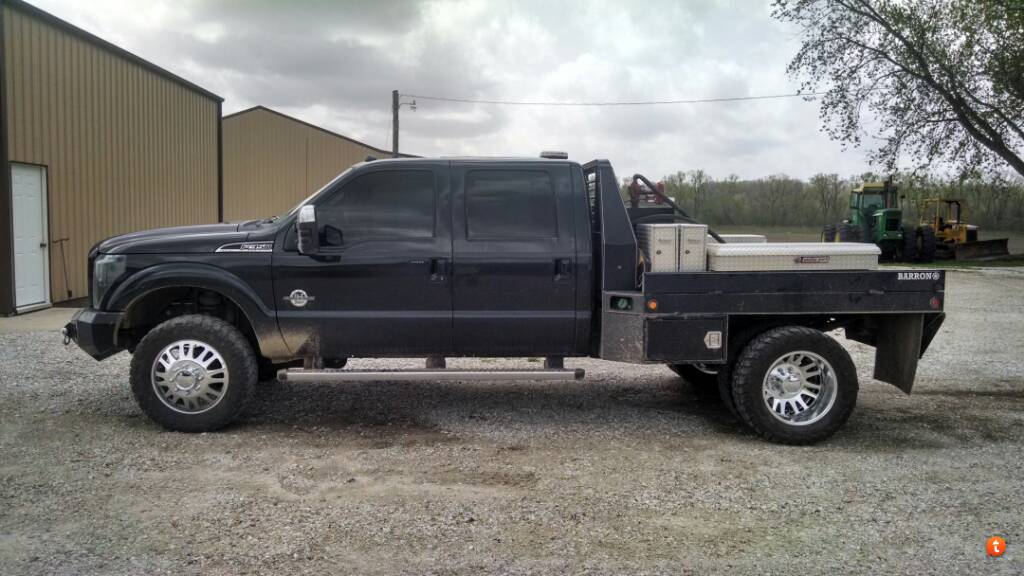

Slow progress since we've been hauling a$$ planting corn but ended up with some much needed rain yesterday. Finally got my wheels on.

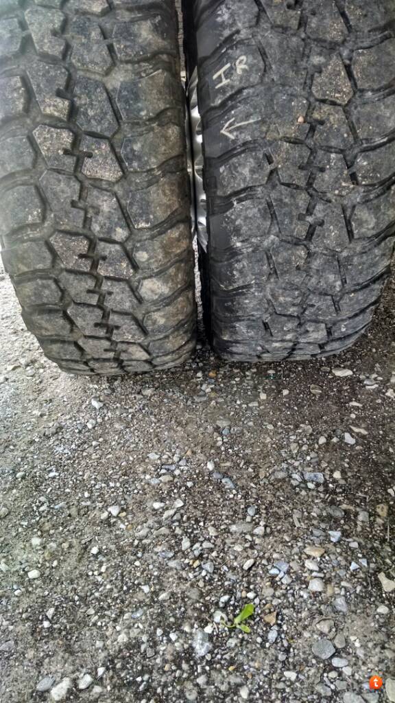

Specs are 20" eagle alloy 056 raw aluminum wheels. For anyone wondering... These are 35x12.50 federal tires (junk ones I had laying around but figured I'd wear them out) and I am NOT running any wheel spacers between the duals. I bought some 2in spacers but after looking at the wheels the inner and outer dual have a male/female centering ring around the hub bore itself to center the wheels together. At first I was going to machine the extruded piece off but figured I'd mount the tires and check clearance. I have about 1.5" of clearance between the duals which is plenty. So just a FYI for anyone that may be interested since I asked around and nobody could give me a answer.

Looks good, bumper seems to tie in better with them as well.
