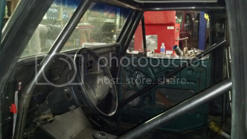

Changed before the next race in 2 weeks.
Put in my front leaf stiffener bar
New front tires
New rear tires
Wire tail lights into switch
Hook up trans brake
Adjust rear drum brakes
Pad the roll bars
Work work!
