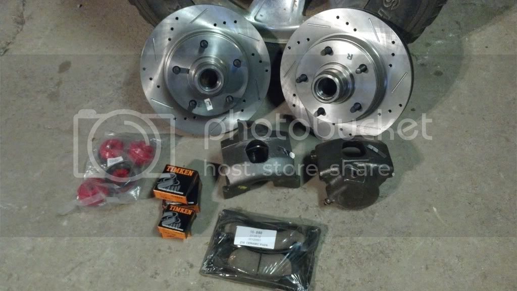

Any suggestions on brakes? trying to decide between running the abs distribution block or come straight out of the master cylinder to the brakes. Thoughts?

You mean aside from the stock one built into the Superduty hydroboost master cylinder? The reason I say that is I thought the stock master cylinder already split the braking 60/40 itself.

It's just nice to be able to fine tune it. I have alot more in the front than in the back. Makes burn outs easier to get fast wheel sleep out of it. And also helps keep my truck from pushing threw the brakes. But I have tiny calipers in the rear and they pretty much don't do anything. Yours is probably diffrent. I've just found that behind able to hold it on the line is A very big issue with 2wd trucks and every bit of adjustability helps.

Yeah I hear ya on the brakes. I have the F-250 drums on the back and they're actually plenty. The front though are the 86 F-150 brakes. I got some drilled and slotted rotors and ceramic pads. That might help them to work with the big drums in the back.

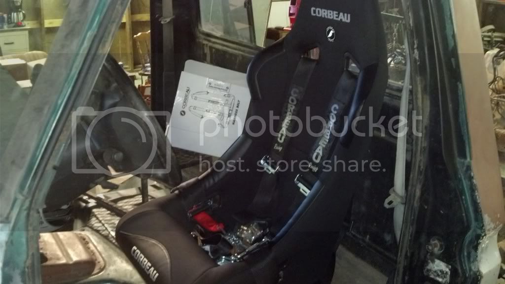

The toys are arriving!! Just one problem.... Seat is too skinny.
