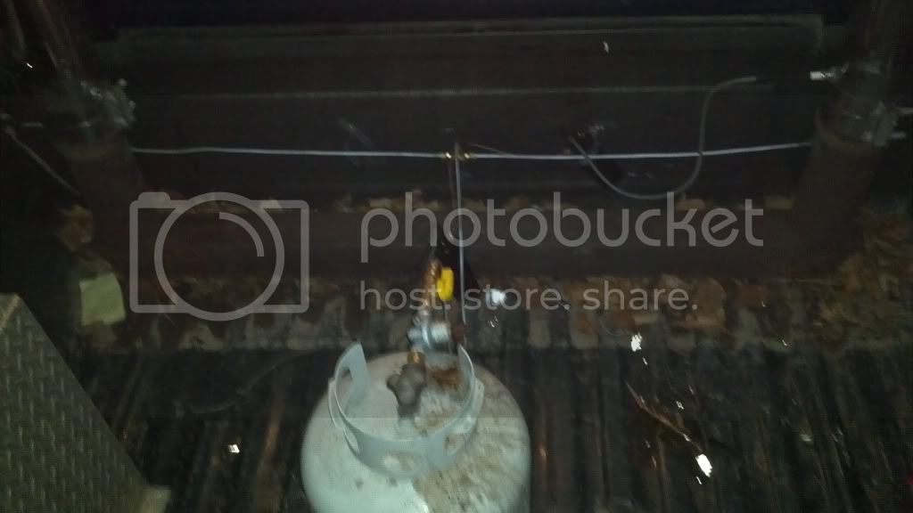

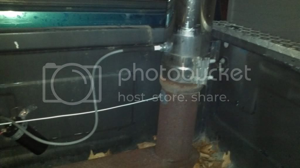

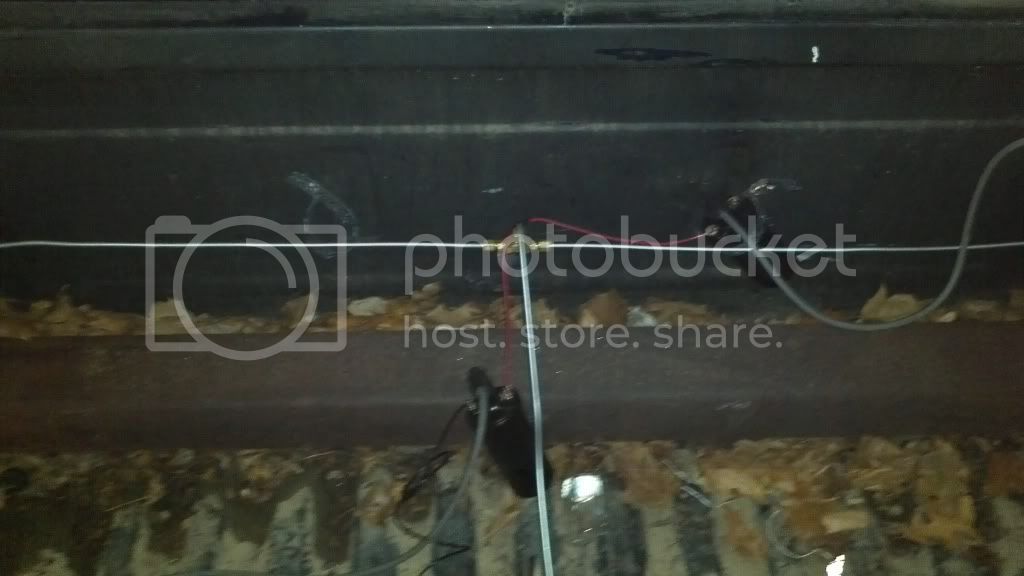

Ok so ran into a problem again.. im running 3/16 lines.. i think they might be to small and im using a new age turn signal relay to turn my spark on and off.. everything is working but its not igniting.. i think my lines are to small but.. its done and here's what it looks like with 3/16 lines
and then all buttoned up nice and neat like

or maybe my lines are to far from the plugs.. im just not sure yet.. im about to break down and just buy a kit.. as much as i dont want to

Do you have any solenoid valves in line or do you just have the one manual valve on the tank?
your supply lines are too far away like you said. Put them an 1" - 1.5" underneath the spark plug and bend the end of the nozzle towards the plug, also widen the gap on the plug to get a long arc.....Please post the pics as soon as it works...That is gonna be bad ass!!

i just have the manual valve right now.. i ordered a nos valve im just waiting for it to get here... i feel like i need my spark to me more constant.. this turn signal relay isnt cutting it.. i have and idea of using a brass elbow in the stack with the spark right above it... im also thinking about upgrading to 3/8 lines.. any ideas ?
use a fuel pump relay instead.maybe two of them 1 for each coil.how are you getting the coils to fire? And 3/8" line not a bad idea either. But get the fuel lines closer for sure.
