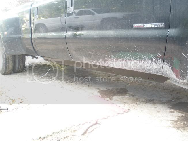

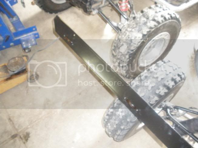

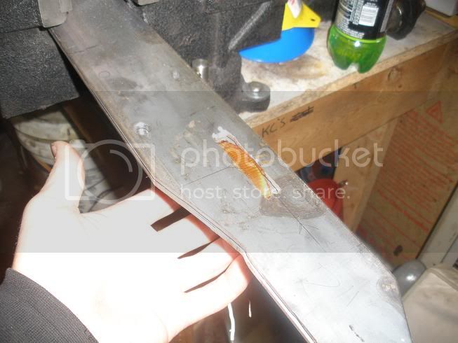

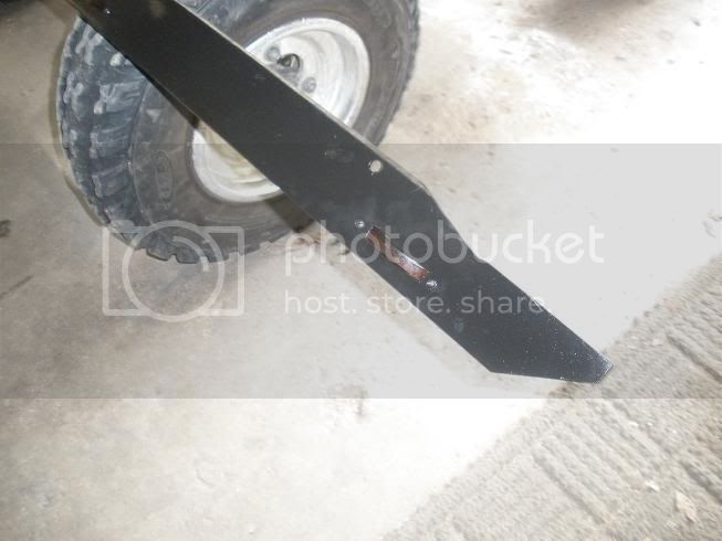

How did you go about making that pinch weld covers any more pics of them?
Its just 3" tall plate, 3/16" I believe, cut to fit on the pinch weld, with holes drilled to bolt through the existing holes. When I first made the plate I used lights that bolted to and mounted from behind the plate like in the following pictures. I repainted and rewired it a year ago using some different lights that bolt to the front with a cover that snaps over them covering the bolts, this is what is in the picture you quoted.
Original mock up.
