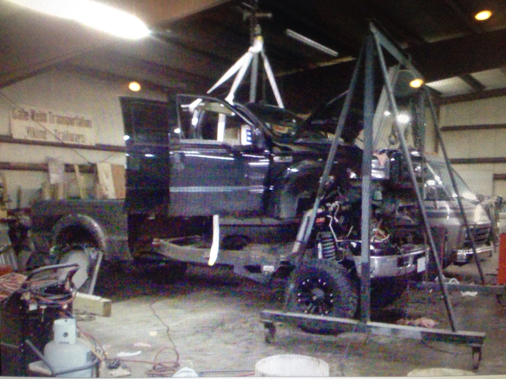

I think I blew my head gaskets last night on my way home. Dropping the truck off at a shop is out of the question at this point and time. I was thinking about building an attachment for our forklift out of 4" square tubbing that would run through the cab to lift it. Will the top of the cab support the weight and have any of y'all done this?

I would opt for some long lifting straps to go under the cab. I'd be afraid of hurting the top of the cab the way you're talking about. But can't say for sure

Thought about that but then the cab could roll or swing.

I did something similar before we had a shop lift on my old 6.0. Ran a 4x6 through the front and rear door openings (I left the doors open for stronger support) then used an overhead crane to lift the cab off. Can't remember if we had to support the front below the grille or not. I'm thinking we didn't. I'll see if I can dig up some pictures.

After I got it high enough we just rolled the chassis and bed under the cab so I had room to work.

Lmao. Honestly, since those guys said they've pulled the cab like that before, I wouldn't hesitate. It'll save you alot of time than doing it cab on, or with the motor still in, and be alot easier on everyyhing.
