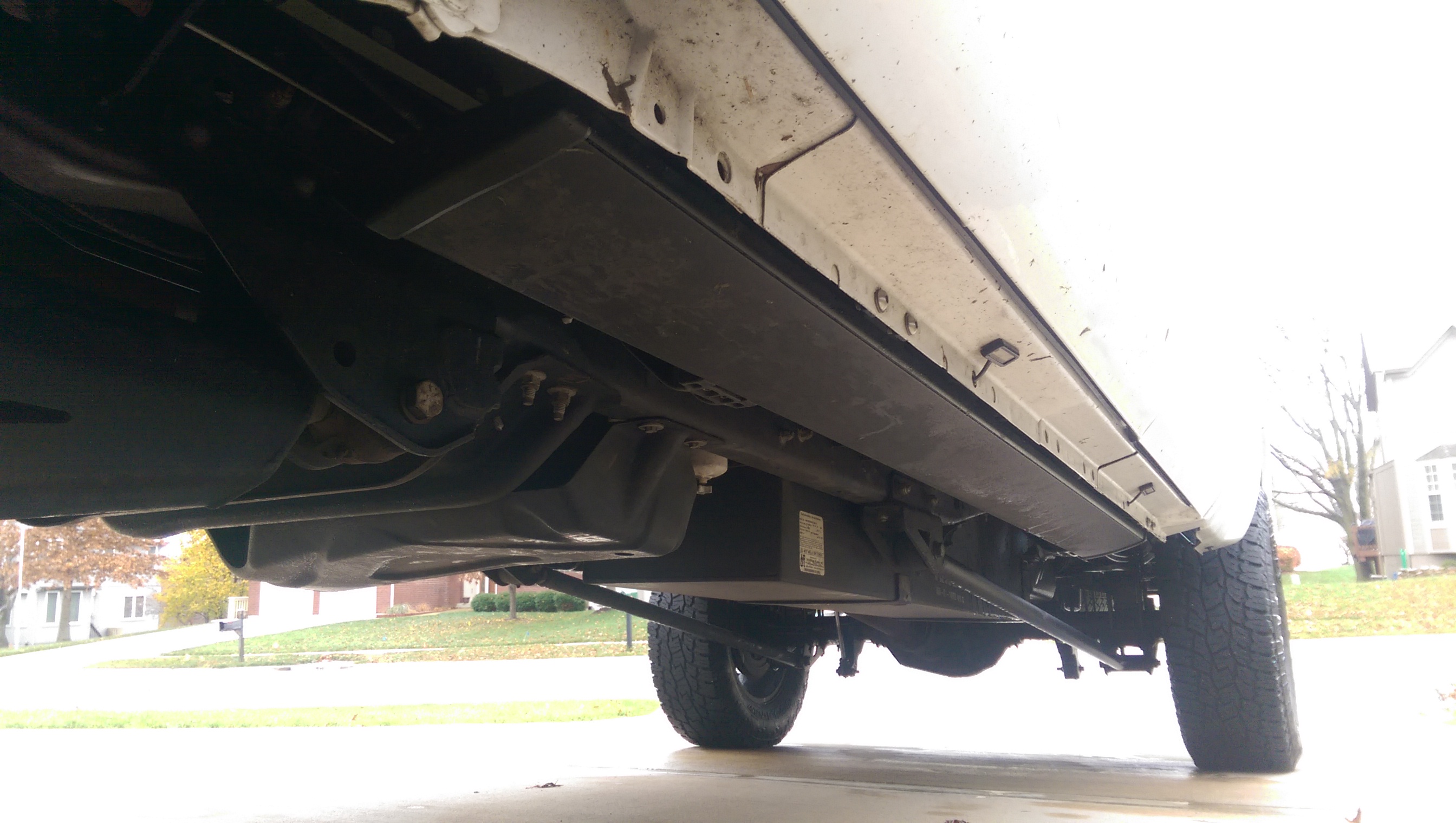

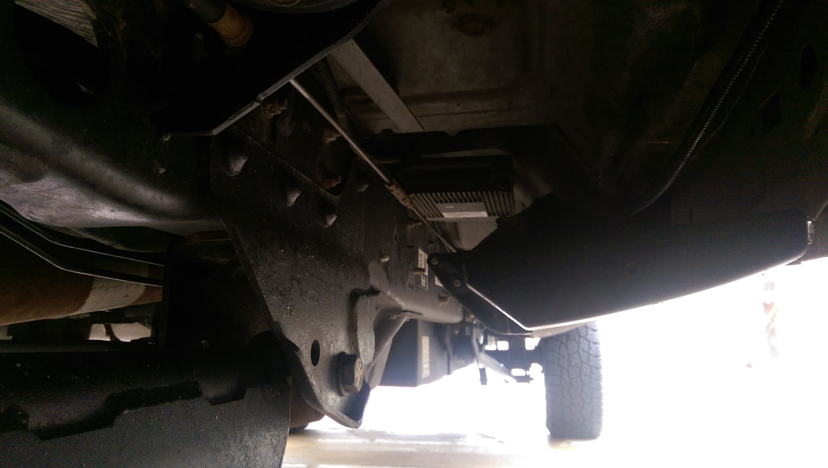

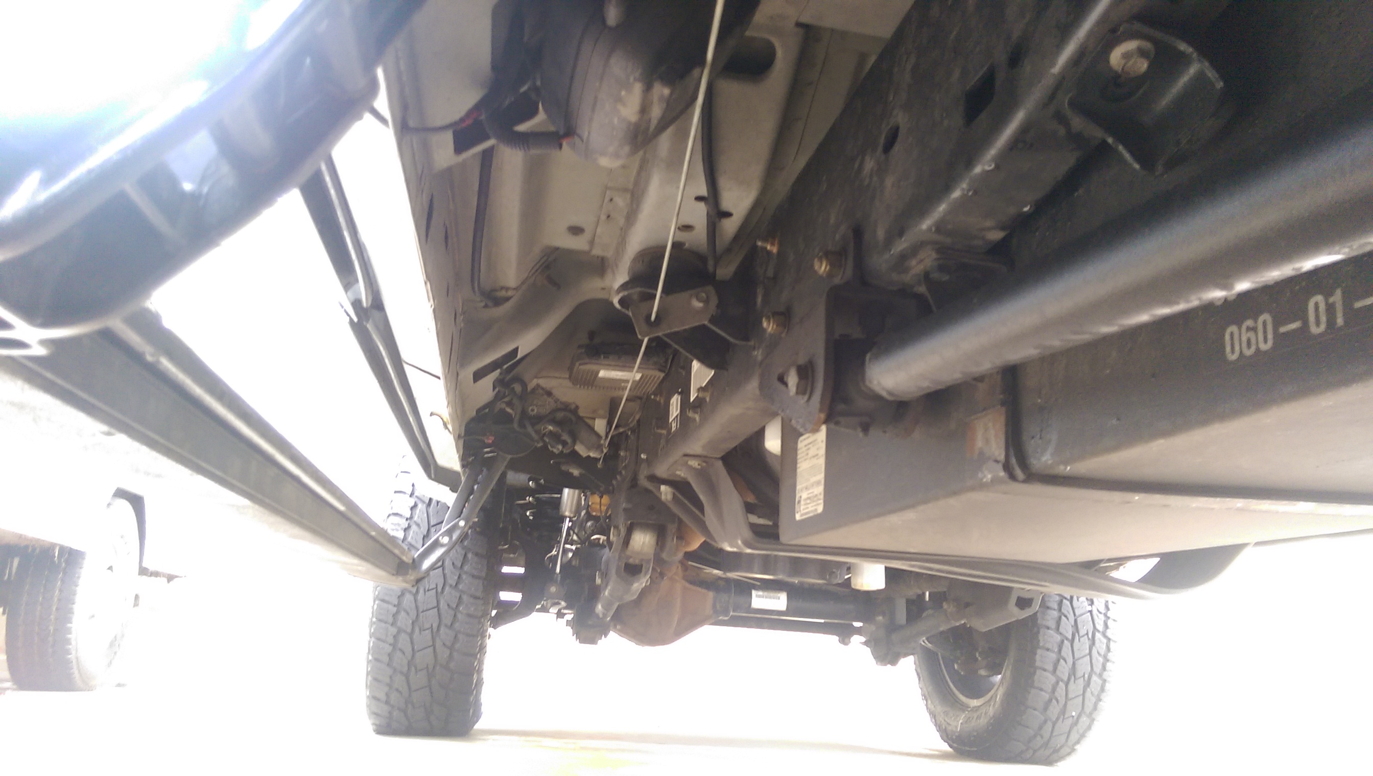

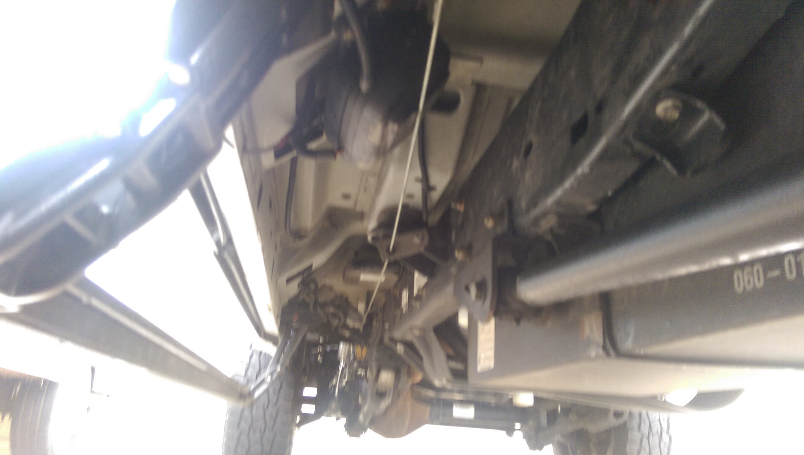

Look what showed up today
I held one bracket up just to see where it sets and I might clear. Hopefully I can get it installed this weekend

I swapped my factory steps onto my Dads 2015 XL f250. And after almost busting my ass every time I stepped out of the truck I knew it was time to jump on the install. I was going to wait for the weekend, but didn't want to wait and tear up my seat or a knee reaching for a step that wasn't there.
Very simple install other then the door trigger wires. When it comes to wiring, that is my one mechanical downfall. Especially fining 4 wires in a loom of 50. The quality of this kit is top notch and everything went together flawlessly. And much to my pleasure it cleared all my air components by an inch. I only had to move my air Chuck which I had coming through a hole in my pinch weld.
