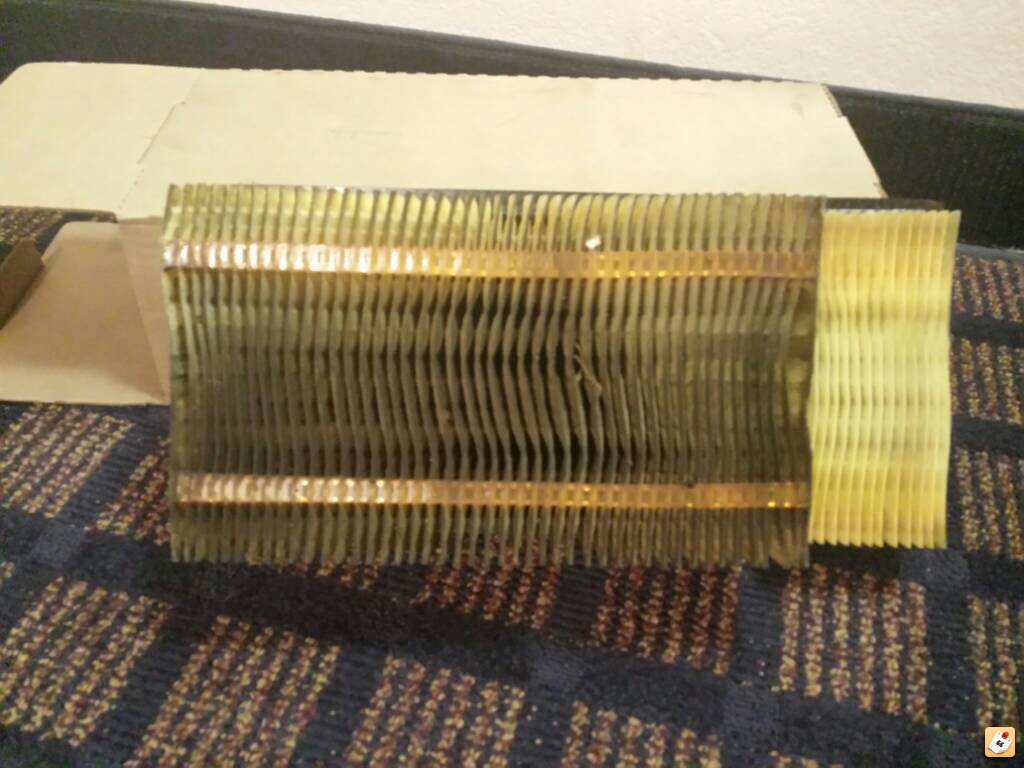

This is the pic I posted before. I blew it out at 8k miles and had just under 15k on kt when I took it out.... Took this pic after
I threw it on the ground and dislodged all the matting across the bottom.... have 5k miles on the new filter and it looks sorta like this already.

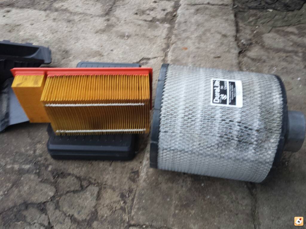

Going to put this in.
What are you using to feed into the turbo end?
The only thing ill change is the air box end. From the flex tube to the fender will be the only thing I delete and get a 45° 4in piece of pipe to got from black flex tube to the big filter with provisions for the maf sensor. Kinda like the 6637 filter mod for a 7.3 only this one flows is 200 or 300 cfm more then the 6637.

That's what I thought you were doing. My point is that you won't have any more restriction than stock down stream of the MAF.
