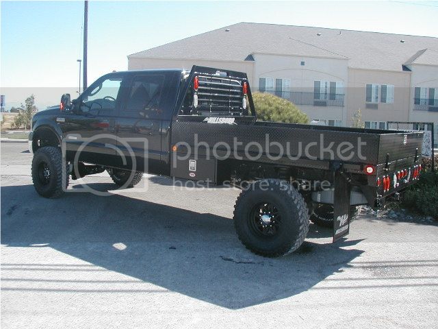

Here's the truck it would be going on

That bed will work. A 9' long flat bed is standard.
You will have to be able to do some fabrication to mount it up. The frame on the truck has a rise above the axles, and the bed frame has a flat frame.
We use square tubing to run across the truck frame for the bed frame to sit on.

I figure for the price I can make something work to mount it, just wasn't sure if the 9 foot length would look goofy and out of proportion.
The truck has a 6" lift and 35s, once I get a bed on it I'll see how it tows. The lift might be coming off in the near future.

Normal bed for a 8' long box is usually 8' to 8'6". 9' bed wouldn't look weird but Its normally made for a C&C. You may have some problems with a goose neck depending on where the ball is mounted. They are suppose to be like 4" forward from the rear axle to give some steer weight. If the bed was made for a C&C with a longer wheelbase, the gooseneck may be placed farther back and may be centered or behind your axle which would be a problem

The gooseneck placement had crossed my mind, I'll have a transfer tank and toolbox at the front of the bed so maybe it wouldn't be bad to have the ball a few inches further back

Just as long as the hitch is at least a little bit forward of your axle. If it is dead centered or behind, I would absolutely not be pulling a goose neck with much weight until you get something figured out.
