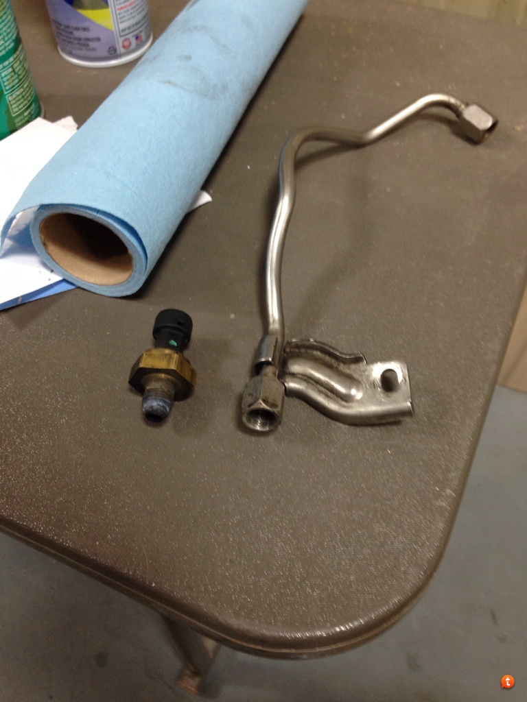

Was throwing the P006B code...pulled the EBP sensor and tube, drained water outta it, blasted it with air, cleared the code, and viola, no mor code. It's around 22* here right now.

I had that happen a few times so I just unscrewed the sensor and started the truck. It blew all the junk out into a rag and I was back in business.

It's a PITA to deal with. Lol. I think my sensor has had it but we will see. Hasn't popped back on since it's warming up.

Yes its a pain! I actually carry a spare sensor with me just in case mine craps out again on me like it did last year.
I'm gonna have to do the same. Keeps throwing code every once in a while, but at least now the vains aren't acting goofy. Lol

Codes came back, same ones, pulled the old EBPS sensor out, drained water, ran engine blasted all the crap out, cleaned tube, put new EBPS sensor in. Going to a test drive momentarily.
