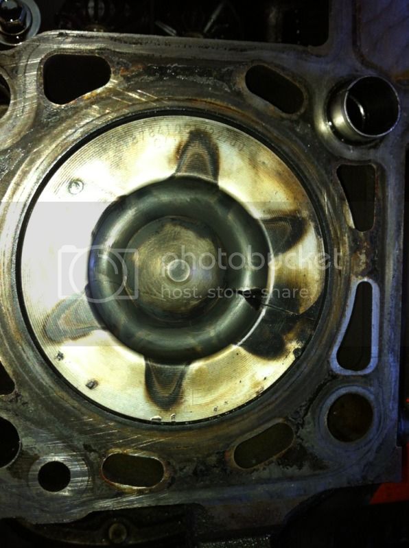

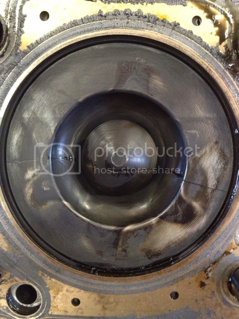

Why don't you jut get a set of Hallers coated International Pistons and throw them in there? I wouldnt go to all that work and not intall a set of pistons, espicialy if you tow often. After cracking a piston in the middle of no where I know how bad things can go and being so close to the pistons I would just do them, even before a cam if you can only do one.
