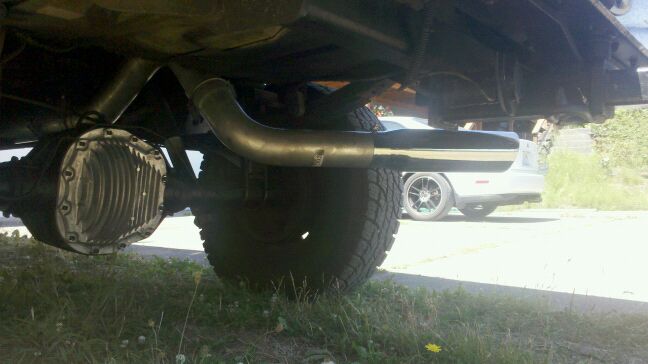

im running mobil-1 synthetic in 75-140 and love it, hope you have longer bolts before you start this project.
FORD7.3
450
Forgot to add a picture and the size of the bolts, im running allen head bolts but you just need something longer, size I used was 5/16-18x1.25
