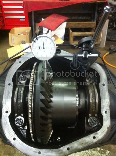

Setting proper Backlash/load is easy so long as you have a good set of feeler gauges.. Although I do it everyday when timing hydraulic fracturing pumps.
91turbogsx
1,554
Gardner MA
Backlash you check with a dial indicator. I've never had to use a set of feeler gauges on a 10.5.
MilehighEX
Sep 27, 2011
33
definitly a dial indicator not feelers...I guess I stand corrected, on the shiming of a 10.5". It has been a while since I have been in a sterling rear, Dana's use the shims under the carrier bearings...thankyou 91turbogsx
OSCS
Jan 12, 2012
1,195
Houston, TX
We use feeler guages to check the final load and backlash. Our dial indicator is used to adjust the pinon to get desired l/bl I guess essentially it the same thing. Interesting to see how you do it.
MossBack
Aug 22, 2011
934
UTAH
When I used to rebuild frac pumps we used feeler gauges as go no go on the slide guides. However pinion was never touched in a rebuild. I do believe hburton pumps are different then other frac companies.
