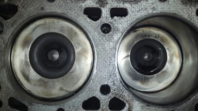

if you have never done it, prolly should watch and learn from a shop. gotta make sure everything stays even and smooth.. bowl radius machining takes the square edge from the factory bowl and radius's it smooth to help stop hot spots and cracking... or it will look like this.. look close to the 12 and 6 o'clock positions on both pistons... all 8 of mine are like that..

***ed up thing is pyro has only been above 1500* maybe twice... and that is my dumb azz fault.. this setup never got hot unless i made it...
